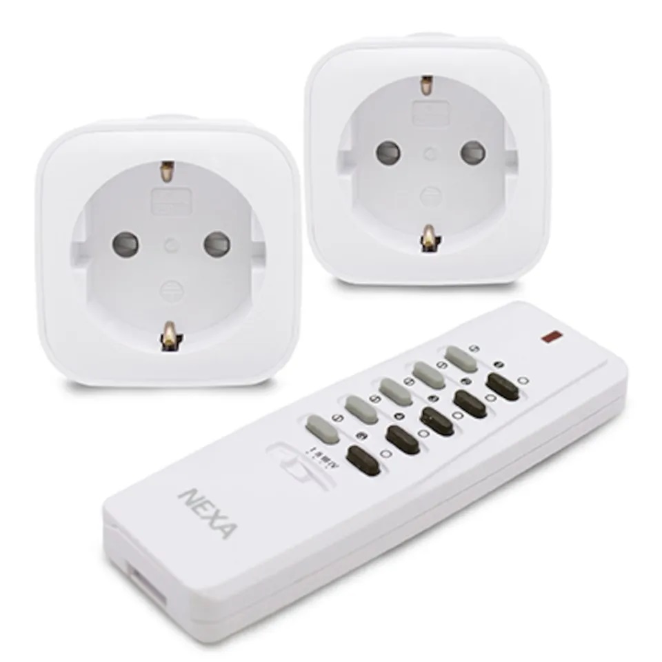

  • Thank you all for the excellent suggestions. Remote on/off support is a good suggestion for regular power down/up, but not going to be very helpful for those times when the power cut has already screwed up something on the SD card. For those times, I had to do disconnect all the cables and reboot everything in sequence to get the system up and running again.
