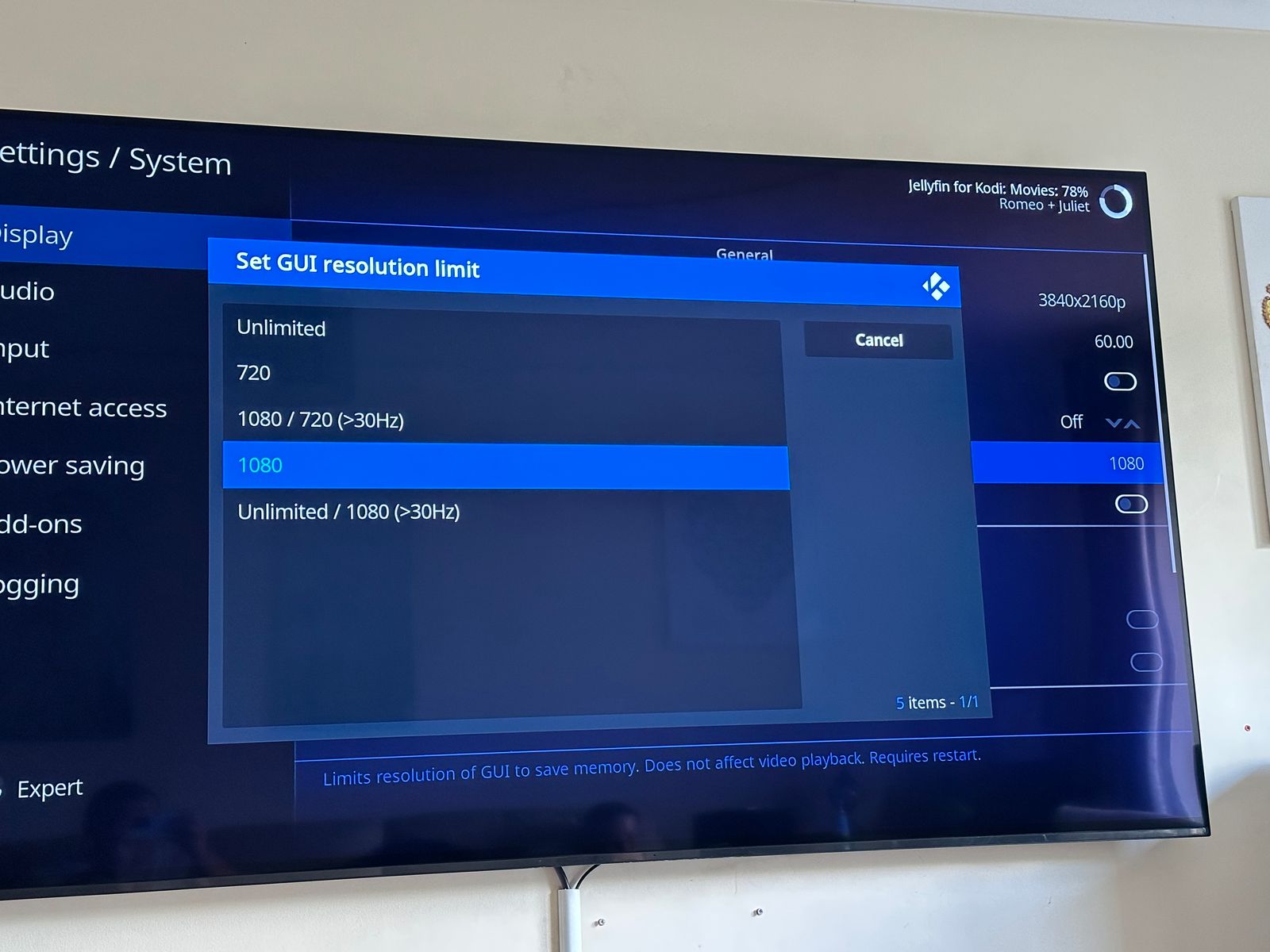

Correct settings for 60fps 1080p UI?

Unless you have a fast Intel CPU device; leave it at the default (1080) setting.
Is this operating at 60fps?
Yes (assuming you have chosen 60 for framerate above.
"Unlimited/1080 > 30FPS" means no limit resolution when current hdmi mode is 30fps or lower, and limit to 1080p above that.
But really keep it at 1080p - the skin only renders to 1080p, so any higher is usually just slowing it down with no visible change.
Also see info here: https://wiki.libreelec.tv/configuration/4k-hdr
TLDR: set default hdmi mode to 1080p60 and whitelist any 4k modes you want when actually playing videos.
