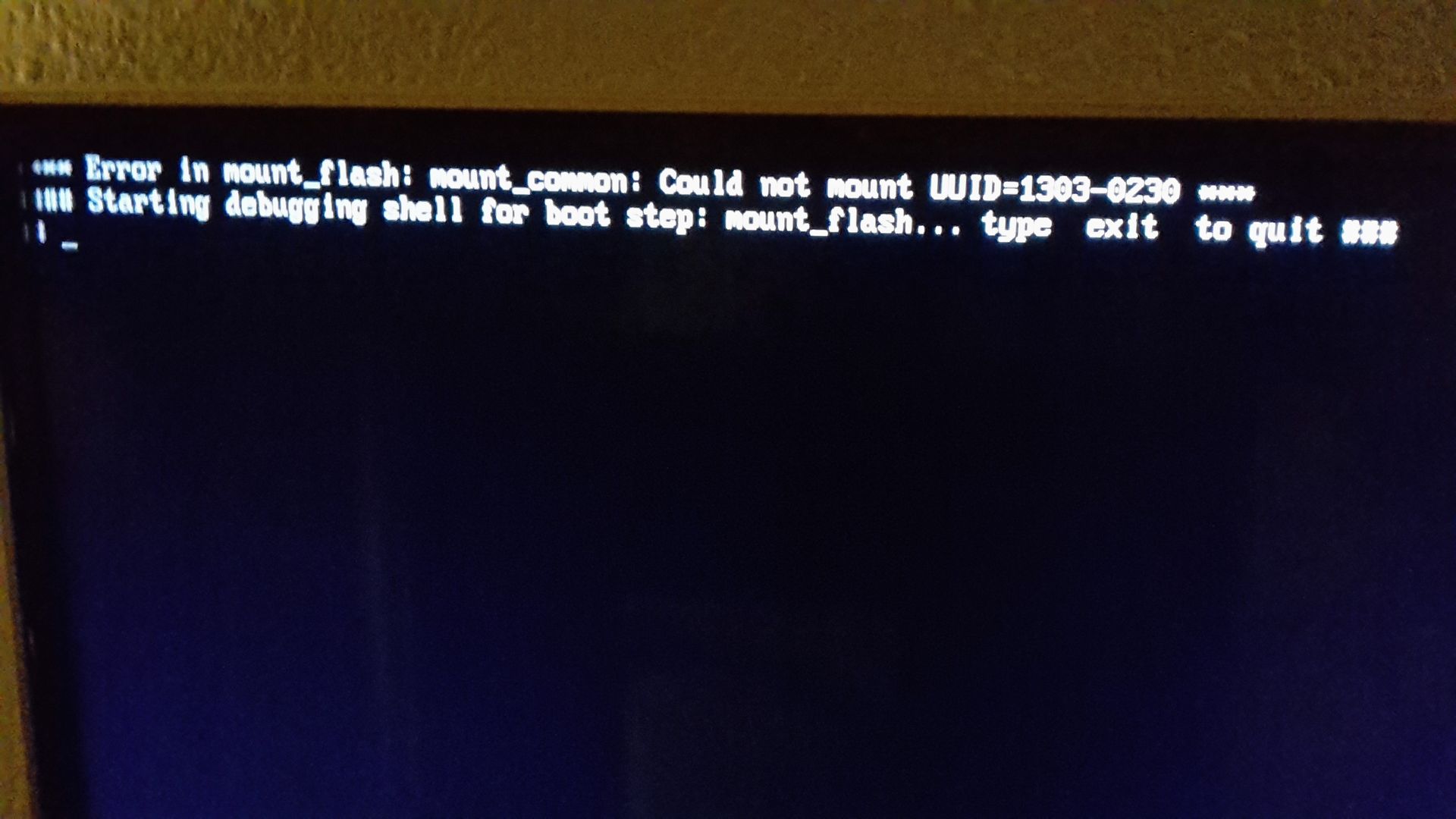

But with sdcard inside the sdcardslot of the box i always get the "error in mount_flash".
sdcard inside a sdcard to usb converter works.

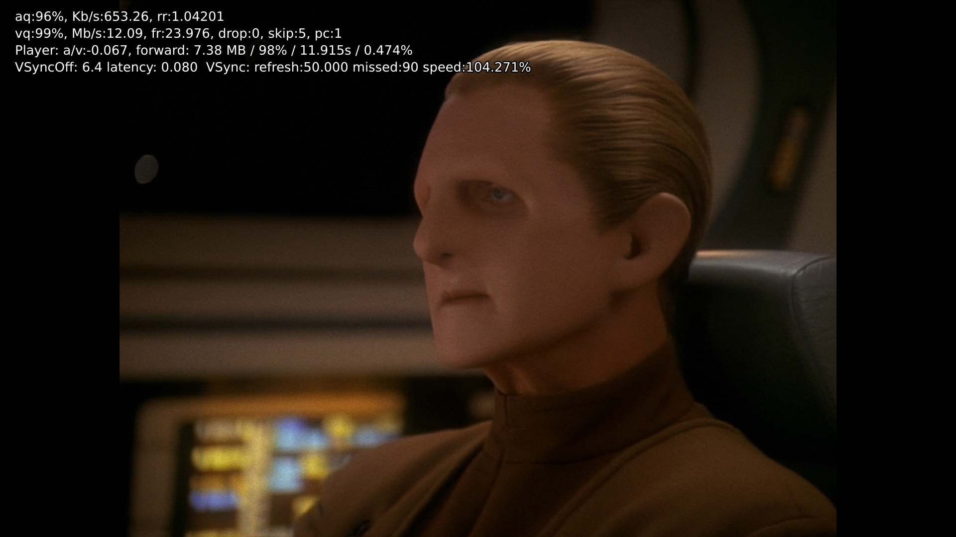

the "FPS_test_1080p23.976_L4.1.mkv" plays some seconds and then hangs with buffer symbol with enabled prime decoder. playing stuff without hardware acceleration us useless.
some other h264 ran fine AAAAND... "SYNC PLAYBACK 2 DISPLAY" works again.
23.976p plays at 104.271% to speedup to 25fps
"Stats" say that "missed" is running up but video runs smooth.

I'd guess the SD card is a newer/faster one and doesn't get reset properly after the initial boot and thus can't be read-from. If you find an old/slow SD card without fancy fast modes it will probably work. Using the USB adaptor sidesteps such issues.
NB: AMLGX is not perfect. If you want to nit-pick on what works/doesn't, you can save fingers from typing forum reports about this/that test file because a) I know there are bugs, b) I know nobody is working to fix them. I'd like to see improvements of course, but until there are some, the reports aren't interesting. Best results come with using the mode whitelist and adjust-refresh. Using "sync playback to display" will probably cause more issues that it might solve. If it works for you, that's nice. If it doesn't,
