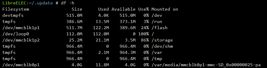

    1) There is a problem with emmc storage as the unit reports a lack of space and many addons (and all skins) fail to install
    2) The restore button and power button on boot do nothing now ... I lost that functionality.
    3) Trying to downgrade reports a lack of space
    so essentially it is pooched ... now what?

    (parted) resize 2 100%
    resize 2 100%
    Error: The resize command has been removed in parted 3.0
    my error in the syntax, but nonetheless is gets more amusing ... I'm working through parted (used the graphical gparted tons)
    parted
    select /dev/mmcblk1
    resizepart 2 100%
    finally :D
    edit: at 'parted", enter
    print all
    to get device names
    resize2fs /dev/mmcblk1p2
    and now storage is 6.3GB in size 8)
    edit: exit parted (I think is was ctrl-c), then type
    df -h
    to get device name to resize (the device associated with /storage)
