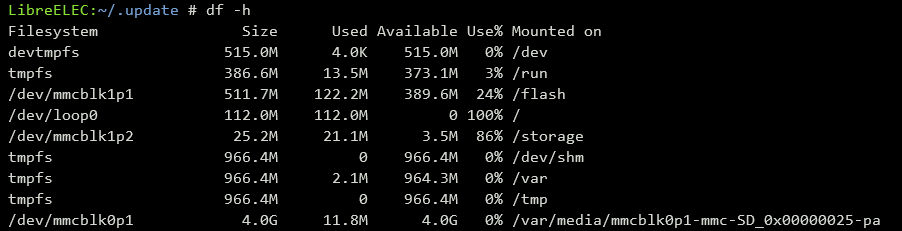

    I was just looking through available commands and found that 'parted' and "resize2fs" are installed on the image.
    The emmc storage is 8GB and I am working to non-destructively enlarge it.
    This still won't allow me to downgrade previously to v11 but should allow for the device to work and install addons.
    the bigger issue at hand is that both the power button and the reset button are non-functional with the flash of 11.0.3; kinda of important items to have working for unbricking/unpooching devices
    this is getting comical
    (parted) resize 2 100%
    resize 2 100%
    Error: The resize command has been removed in parted 3.0
    my error in the syntax, but nonetheless is gets more amusing ... I'm working through parted (used the graphical gparted tons)
    parted
    select /dev/mmcblk1
    resizepart 2 100%
    finally :D
    edit: at 'parted", enter
    print all
    to get device names
    resize2fs /dev/mmcblk1p2
    and now storage is 6.3GB in size 8)
    edit: exit parted (I think is was ctrl-c), then type
    df -h
    to get device name to resize (the device associated with /storage)
