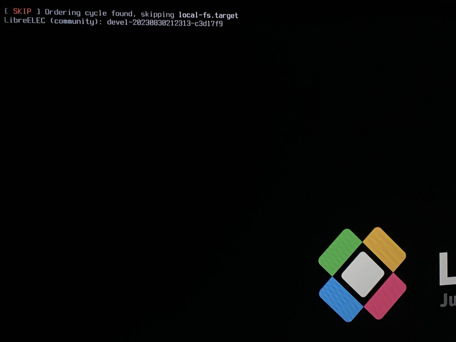

    so i took an SD card that i burned with the latest v12 nightly image, mounted it on a linux PC and replaced the SYSTEM and KERNEL files with the files from the "target" folder in the tar you posted. It booted up and was now reporting that it was running your development version. Did I do that correctly?
    Anyway it ran fine and was working, including CEC. But I left it idle though and it froze after about 20 minutes. After a power cycle it it immediately says "[SKIP] Ordering cycle found, skipping local-fs.target" and sits there.

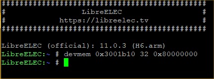

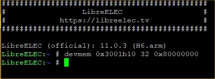

  • hello, i ve been some days offline, now i see many new messages about freezing issue, just send that devmem command via ssh but not sure if i did right, shoud i expect any feedback message after sending it?, do i need to re-enable CEC in settings?

    By the time I came across this thread I went straight to the devmem command, which seemed to work.
