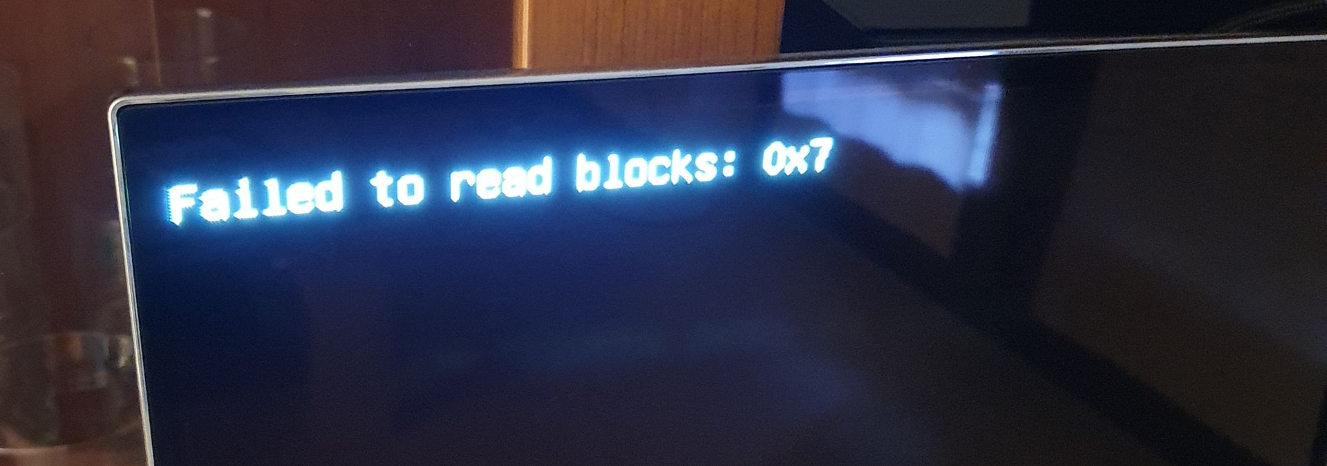

Failed to read blocks 0x7
  • Good morning everybody
    Hope someone can help, i really want to cry :(
    Alright.
    I got myself a brand new Intel NUC as the previous one didn't want to function anymore.
    I had a lot of problems with the LibreELEC image creator, who would always stops 2-3 seconds before the end of the writing, FYI.
    I used another tool to write it and installed LibreELEC on the NUC. Everything went well, i got LE and Kodi, this was thursday eveving.
    The next day, i turned the NUC on, and got this message : "Failed to read blocks 0x7".
    I tried to do several things, looked on the internet... Updated the NUC's BIOS version (it is brand new but is from 2020 i think ;)), then got a few other errors, that i think i solved...
    Then i wondered if the LibreELEC image/version was well written the first time (which may be a strange thing to think about, as it was working well...), and tried to write it again, this time with balenaEtcher.
    I got the image written and wanted to install LibreELEC again... But this time i got a "The selected boot image was not authenticated" message.... I guess this is not the proper way to install LibreELEC again when it's already installed ?
    Now i'm back at the "Failed to read blocks 0x7, the NUC won't start.
    Please can somebody help me ? I would really like use my new NUC ;)
  • Hi, I suggest to you to try that "brand new intel nuc" with something else. Like try to run a live linux (Ubuntu) from an USB stick, try to install it, reboot few times. I think, as it's a number of peoples using the LE with Intel NUC or similar, in your case a defective device can't be excluded, even for a brand new hardware.

  • Hi, if you managed to install the Ubuntu and working well... it's a good news.
    If you still want to install the LE, you should focus to that issue when you tried to write the image to USB.
    Maybe that "another tool to write" wasn't able to write the image exactly how should to be?
    Did you start the LibreELEC image creator with admin rights? Or tried with another USB stick?

    I think at the end the issue was coming for the usb stick, as you've been thinking since the beginning Vlouis, because it Was opening many windows at the end of the writing (different discs). I thought it did the necessary by clearing the differents parts and by just having one, but it seems the issue is still here, as i got some windows opening after the end of the writing (this time indeed, the writing didn't stop before the end of the writing).
    I've intalled LE (instead of Ubuntu).
    Kodi is there, it's all great.
    I switched it off then on again, still working.
    Then tried to lauch it again, but it remained on the "Intel NUC" screen for a while...
    I switched off and on again, and this time, the "Failed to read blocks 0x7" is back... ;(
    Seriously, the writing was fine this time. You will tell me to get back to Ubuntu and install Kodi on it... But all this is on my tv, i don't want Ubuntu, which is more for PC's it seems...
    None of you knows what to do about this error message ?
    How come it could run, and then not run, i don't get this...
    Thank in advance for your answers

    I've just ran the test, let it run for 25mn to be sure ;), and it's all fine.
    Of course, when i lunched the NUC again, i got the "Failed to read blocks 0x7" error message...
    Seems it's a pretty unknow message, is it ?
    Have you or VLouis another idea, another test or check to do ?
