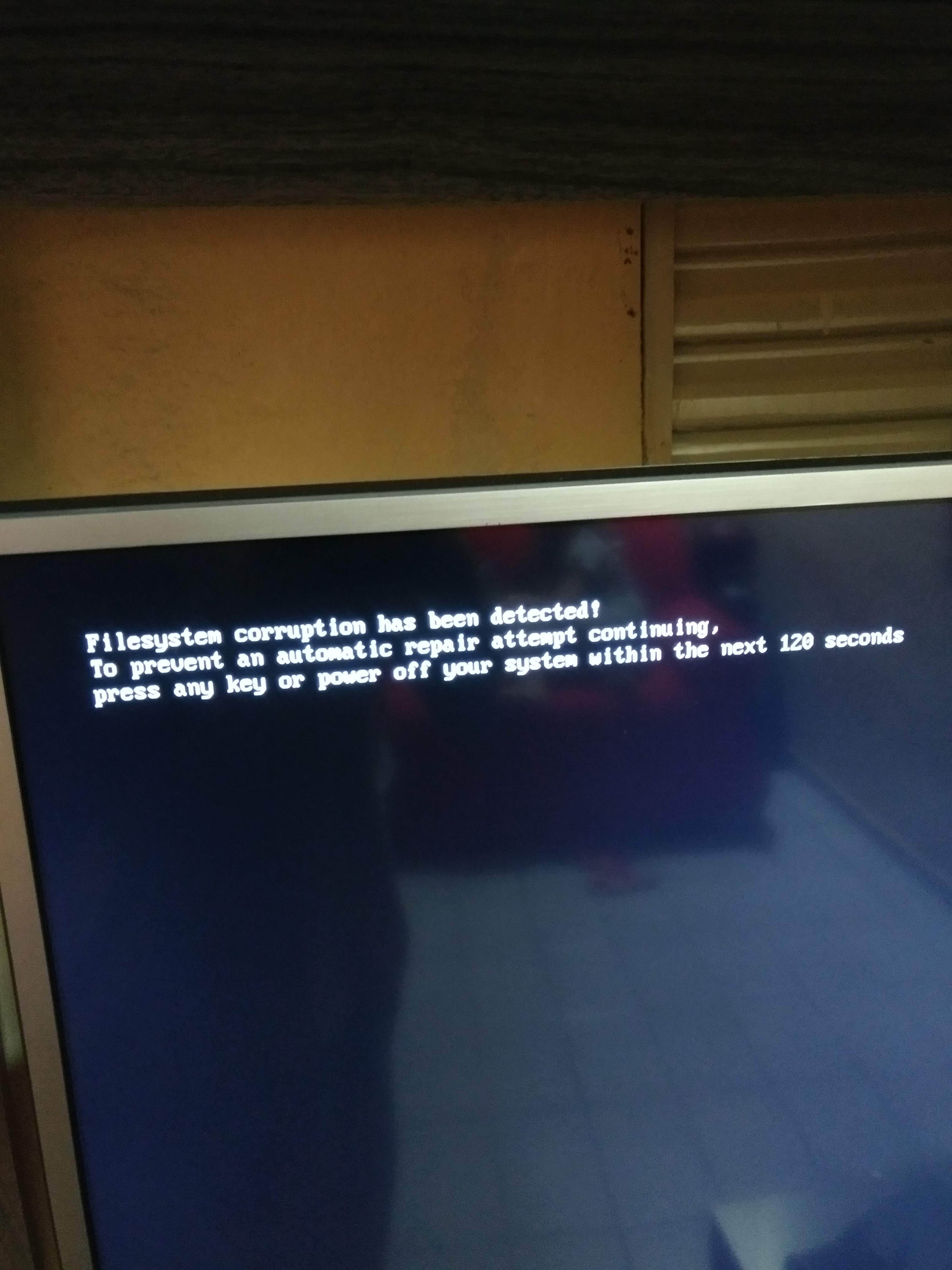

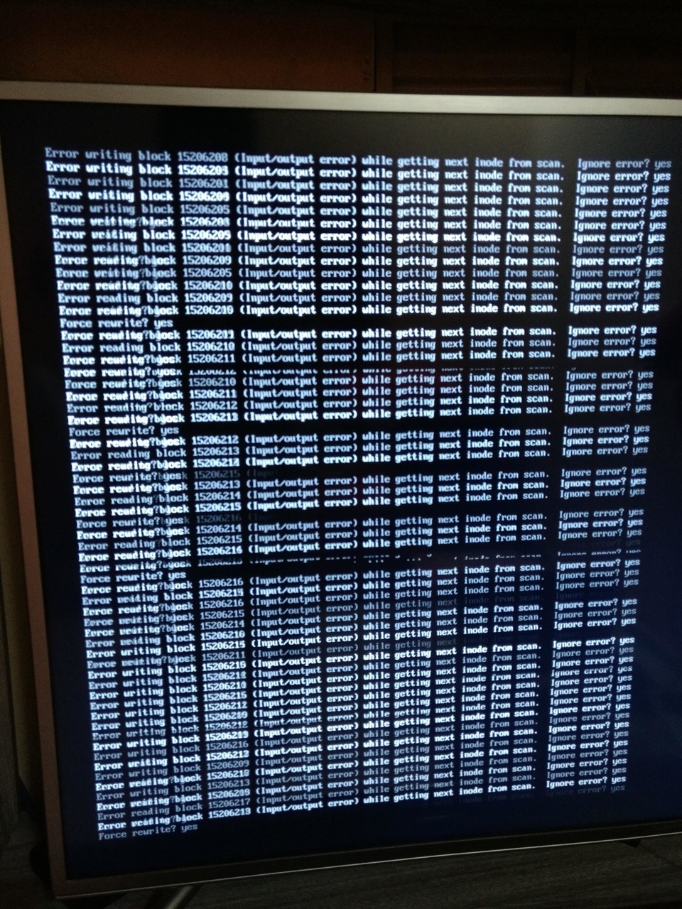

    So, when I wake up today and check my pi it was freezed. I reboot it and this message show up (image 1).
    I left it to see if it repaired by itself and returned to normal, but some time has passed and the system still showing this (image 2).
    I think I'll have to rewrite LibreELEC, install everything and make all the settings from scratch. I should have made a backup :(

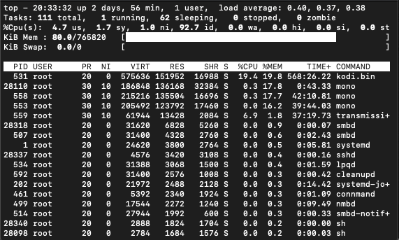

    But for the record: the system ran from 10 a.m. to 3:30 p.m. (when the system freezes).
    At midnight I checked the memory usage and rss sync. The memory usage was 86%. The rss sync of sonarr/radarr and everything was okay. I think this limit is adequade (at least for who those use 3 indexers like me).
    I was runing sonarr, radarr, bazarr, jackett and transmission. My Transmission is configure to only download during at dawn.
    I think if I was not using the bazarr this would not have happened. Or maybe a reboot at 12 a.m solve this.
    Is much complicate using all this on pi, unfortunately.
    When I finished configuring the whole system, I'll test again and tell the new results.
    Thanks for helping!
  • I have no idea what caused filesystem corruption
    But writing a lot to SSD is not a good idea, especially on a Raspberry Pi where network and storage share the same bus
    Try using an external disk for storage
    As for memory, Bazarr, Jackett, Sonarr, Radarr each use about 100MB, and more than 400MB together
    Add Kodi and Transmission, and you easily reach the memory capacity of a Raspberry Pi
    Try MemoryMax=100 and MemoryHigh=125 for Bazarr, Jackett, Sonarr, Radarr and Transmission
    Also try phasing activity of Bazarr, Jackett, Sonarr, Radarr and Transmission

    So, 2 days running without freezings and reboots (image). I'm running Sonarr and Radarr with MemoryHigh=125M and MemoryMax=150M too. But not running Bazarr, just Radarr, Sonarr, Jackett and Transmission. And now doing the downloads direct to external disk 😁
    If the memory usage stay at ~80% I will do nothing, but if it increase I will try add a WatchdogSec= in Sonarr/Radarr/Jackett for something like reboot every day, or maybe learn how I do this using .timer
    Maybe I try add Bazarr to run just during at dawn and in the same time I stop Kodi (to prevent the freeze), but not for now.
    It's a bad ideia put MemoryHigh=125M and MemoryMax=150M by default in Sonarr, Radarr and Bazarr too? For at least for Raspberry devices (I don't kow how many LibreELEC devices have little memory) and putting a disclaimer in readme section, explaining it have to add cgroup_enable=memory in /flash/cmdline.txt to make this work (just an idea).
    Thanks again for helping :)
