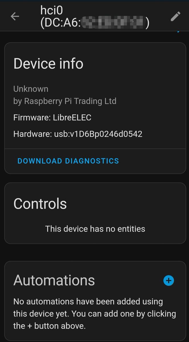

  • I'm using docker-compose here ,but here's a snippet from the "docker-compose.yaml" file :
    With this configuration ,the RPi4's internal bluetooth is automatically detected in HA (check the attached screenshot ).
