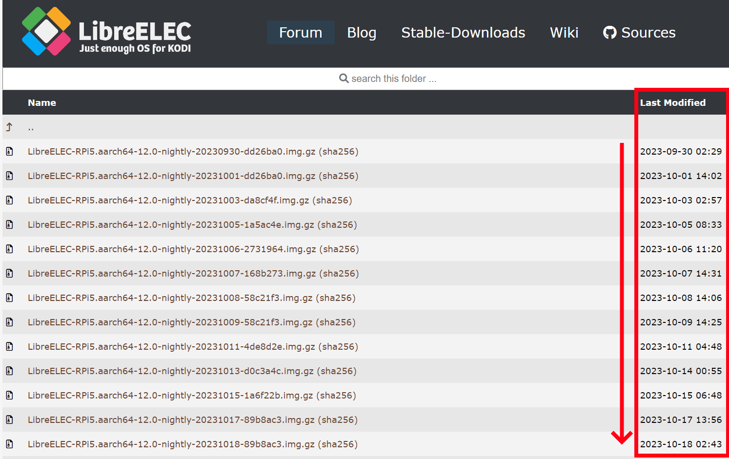

Hi,
I installed LibreElec 12 and I cannot access the LibreELEC Add-ons repository, I get the message "Unable to connect to the repository". (it is possible that the message is not exactly the same as it is written in French).I am connected via ethernet and everything works correctly.
The version he is trying to connect to is 11.80.0
Thanks for your help.
Charly
moi952 I'd guess you installed an older nightly image and the 11.80.0 (alpha) repo it requires no longer exists. Update to 11.95.2 (LE12 beta2) and it will be using 11.80.6 which does exist.
if you took a nightly version pls be aware that the oldes versions are ontop of the download page and the latest are at the bottom - we are aware of that issue
Thanks, that was exactly my problem.
