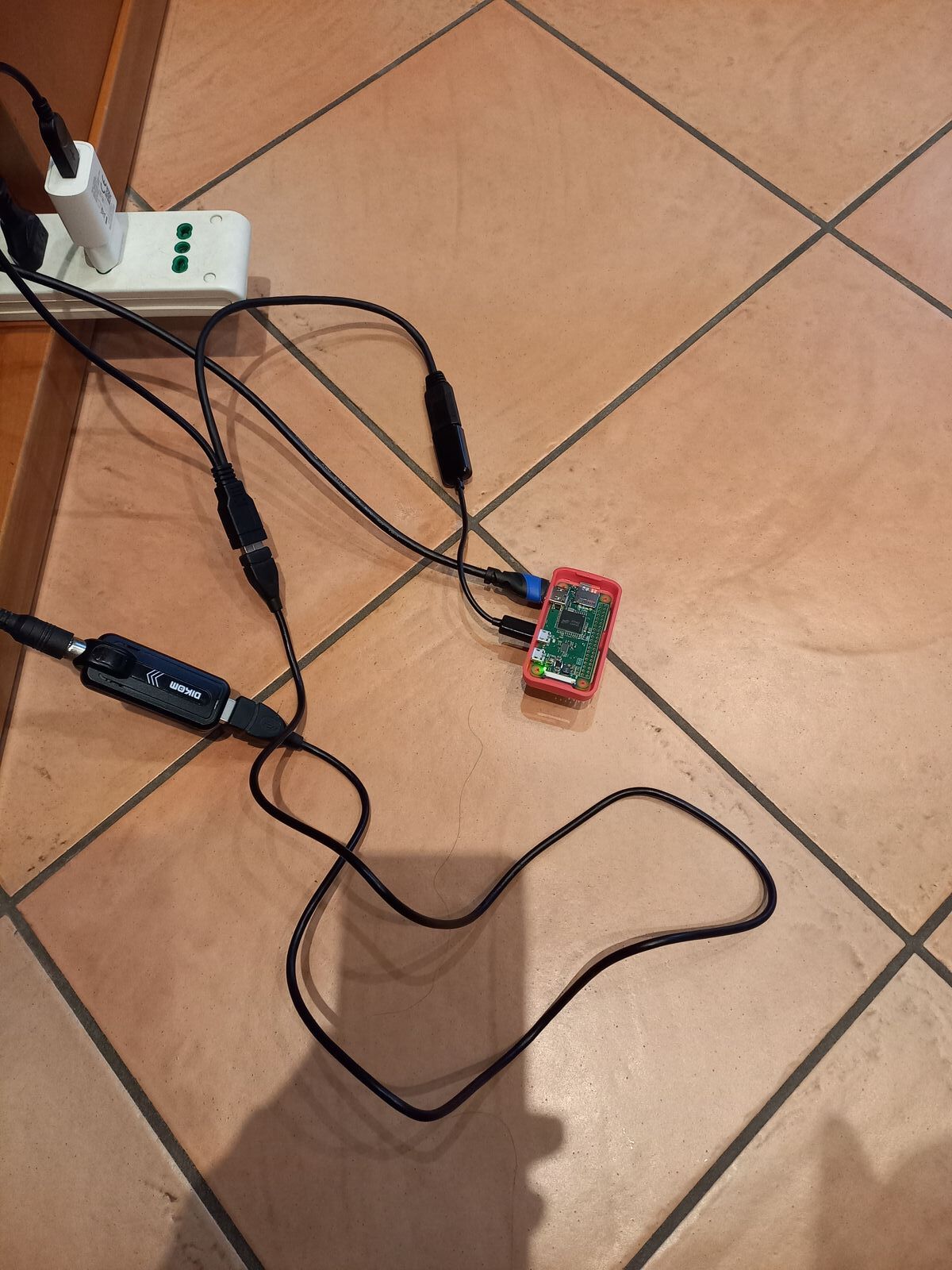

  • hello, I have a Dikom Dvb-t2 tuner but if I connect it on USB port of my RaspberryPI zero W, running LE 9.2.6, nothing happens. Dmesg shows absolute no messages about it. I connected it by y-cable to give external power to the tuner. A mouse connected with same cable is registered in dmesg.

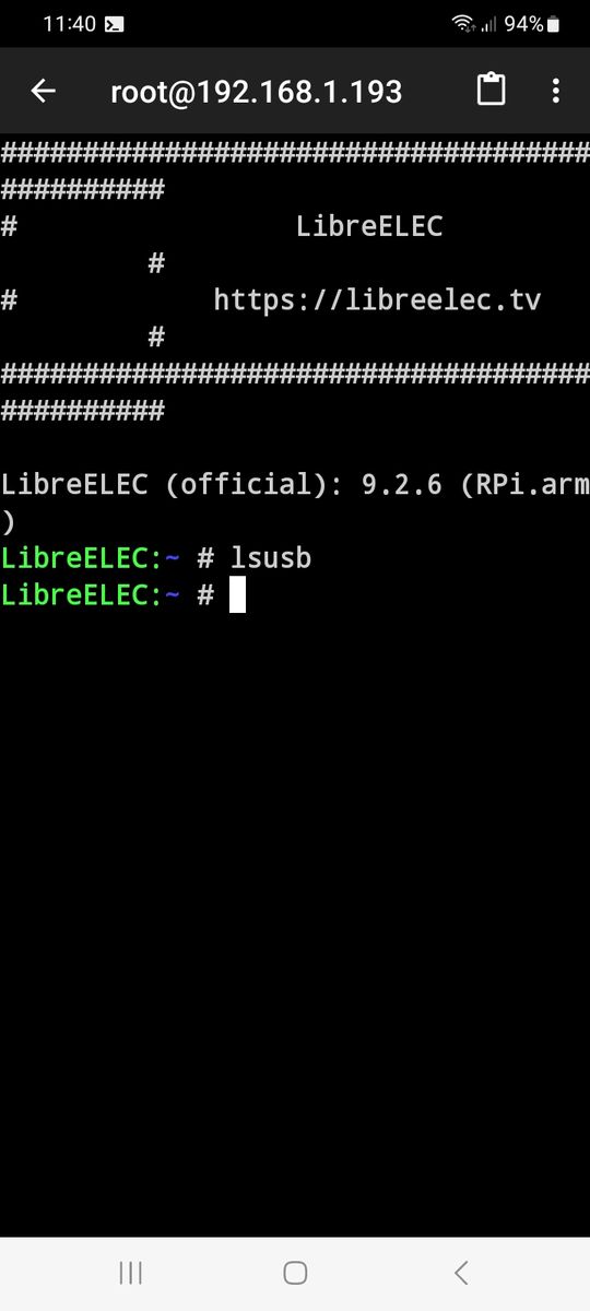

    lsusb output is null so I cannot share nothing

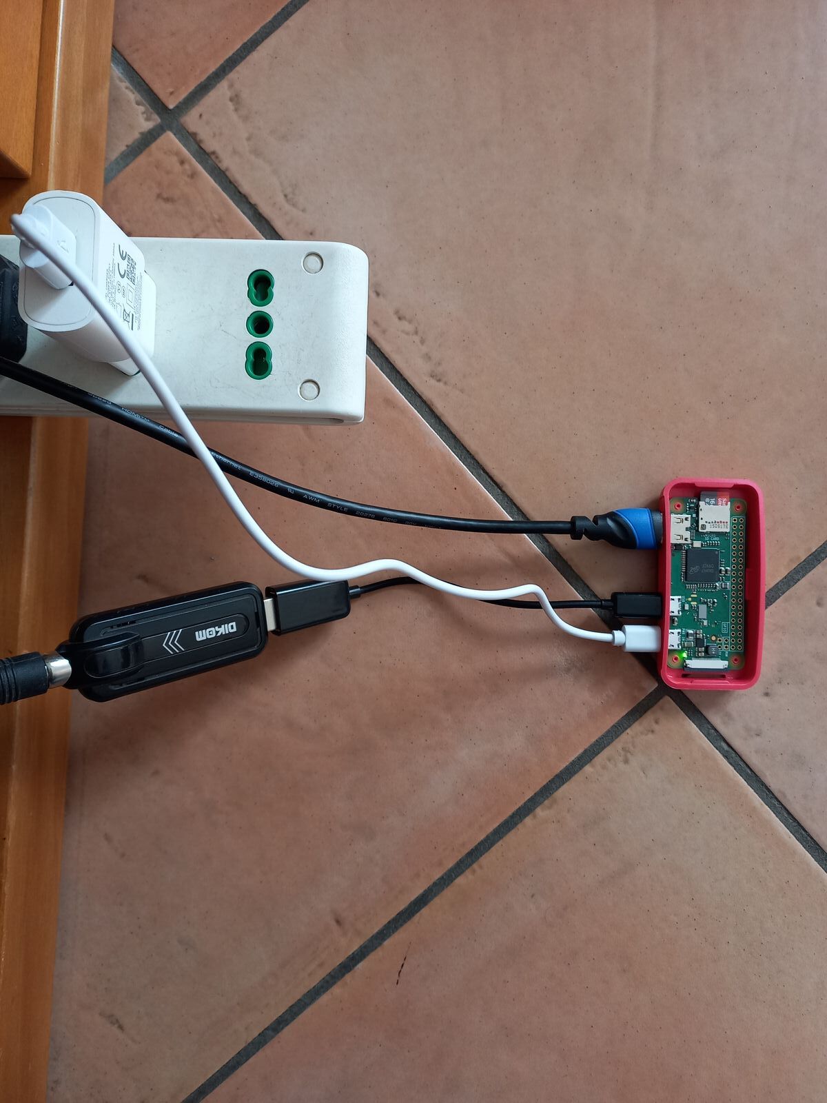

  • my setup
    Unfortunately, I don't have such a device, but are you sure this USB Y-cable with OTG-adapter is suitable for this purpose?
    Maybe the middle two USB wires (DATA+/DATA-) are not shared in this Y-splitter (or I don't know, what is this), so I think this will not work.
    I think the tuner only gets the power and that's it.
    You should try adding a dedicated power supply to the 2nd micro USB port (I mean a real power supply, not a phone charger) and connecting the tuner to the first via OTG.

  • Alrama, Yes it looks as though tuner is still not recognized. Is it possible to connect the tuner directly to pi without otg cable just a regular data cable and see if pi will recognize it by doing lsusb? Maybe this way may not work and that's why raspberry pi came out with the Tv hat which has a DVB tuner included in it.
  • The interesting thing is that lsusb should also show the USB host chip (or the root hub).
    If you unplug the OTG-cable and boot without that (empty first port), is the output still null?
