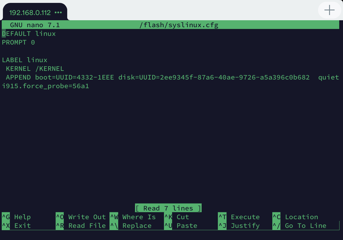

  • atoulmin -
    Confirm that i915.force_probe=56a1 Is on the same line as quiet in syslinux.cfg
    Can you please share the full dmesg want to make sure we are heading in the right direction.
    Run modprobe i915 force_probe=56a1
    Share the dmesg output from the modprobe.
  • So I didn’t realise it had to be on the same line, adding the force_probe at the end will now boot LibreELEC into Kodi. Hooray.
    However when I attempt to play a video I get sound, but the picture will Goto switch but will revert to Kodi menu. The movie will continue to play with sound but no video.
