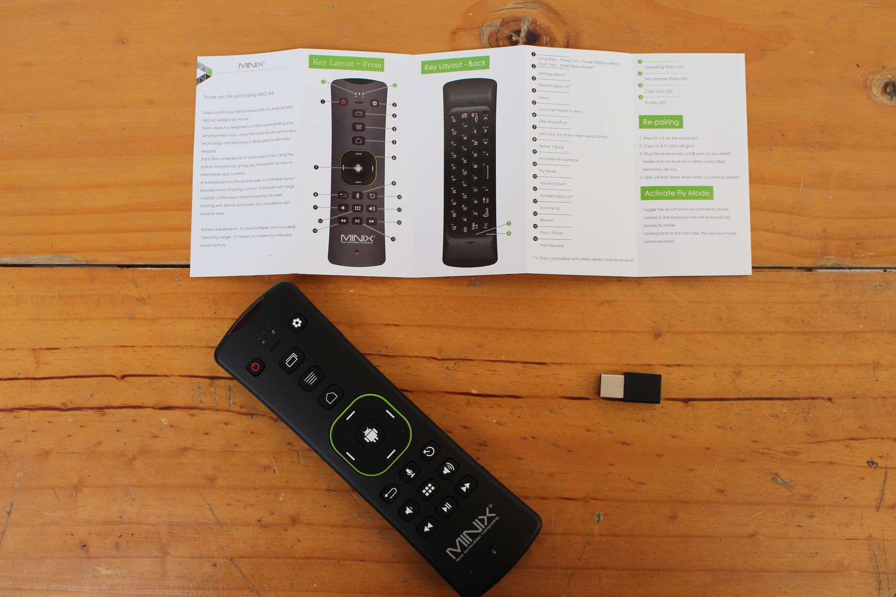

    i am able to shut down the device, which i configured with the keymap editor addon.
    My Problem is to Power on my device. In keymap editor there is no option for that.
    Does anyone have an idea to configure the red button to power on ?
    I own a minix remote. I run LE on beelink ap34 with apollo lake chipset.
    Thanks in advance!
  • RF dongle located in one of the two battery compartments located on the keyboard side.
    Is the Minix remote (re)programmable? (to send a specific wake code) .. and does the Beelink box have a power-on/wake IR code?
    Where can i check it, could you give me more information?
  • It is not in standby mode. It is completly shut down. Any idea to send the magic packet to power on? As i said Power off works which i edited in keymaps editor.

  • Power Off is simple to handle because there's a functioning OS that can be (re)programmed to deal with whatever IR or RF keyboard codes the remote sends to run a shutdown. Power On requires something to always be powered and listening/waiting for a specific IR code; that wakes the internal power circuits to (re)start the device. And yes, about 95%+ of all hardware used for LE (all RPis, all NUCs, etc.) do not have that little extra circuit that remains powered to switch things on again. RPi devices can be modified with an add-on board that hosts an IR receiver and a small power circuit that's always-on and provides board power via the GPIO pins. There are IR/remote add-on "lids" for some NUC devices too; but rather expensive.
    TL/DR; If the Beelink box has an IR wake function? you might be able to get a programmable IR remote and configure it to wake the box. I'm quite sure the Minix remote is not programmable though, so even if it does have one you're not going to make that combo work.
