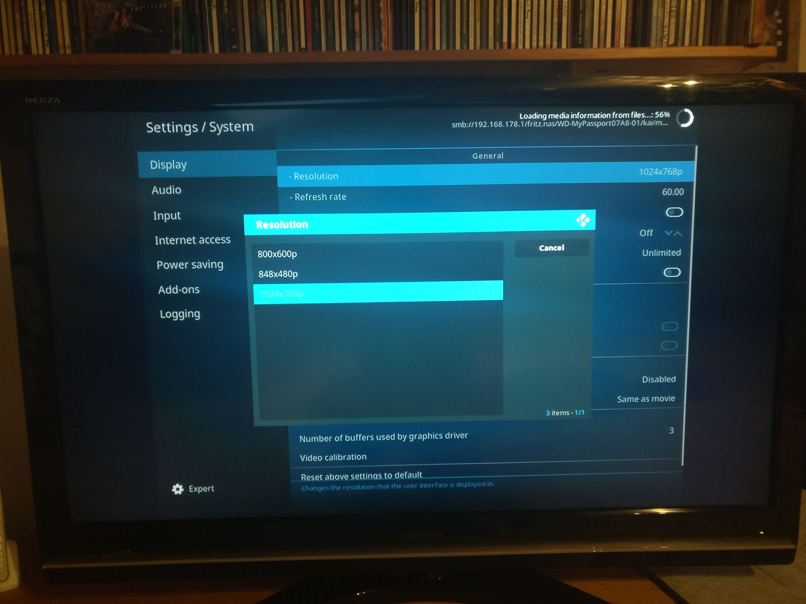

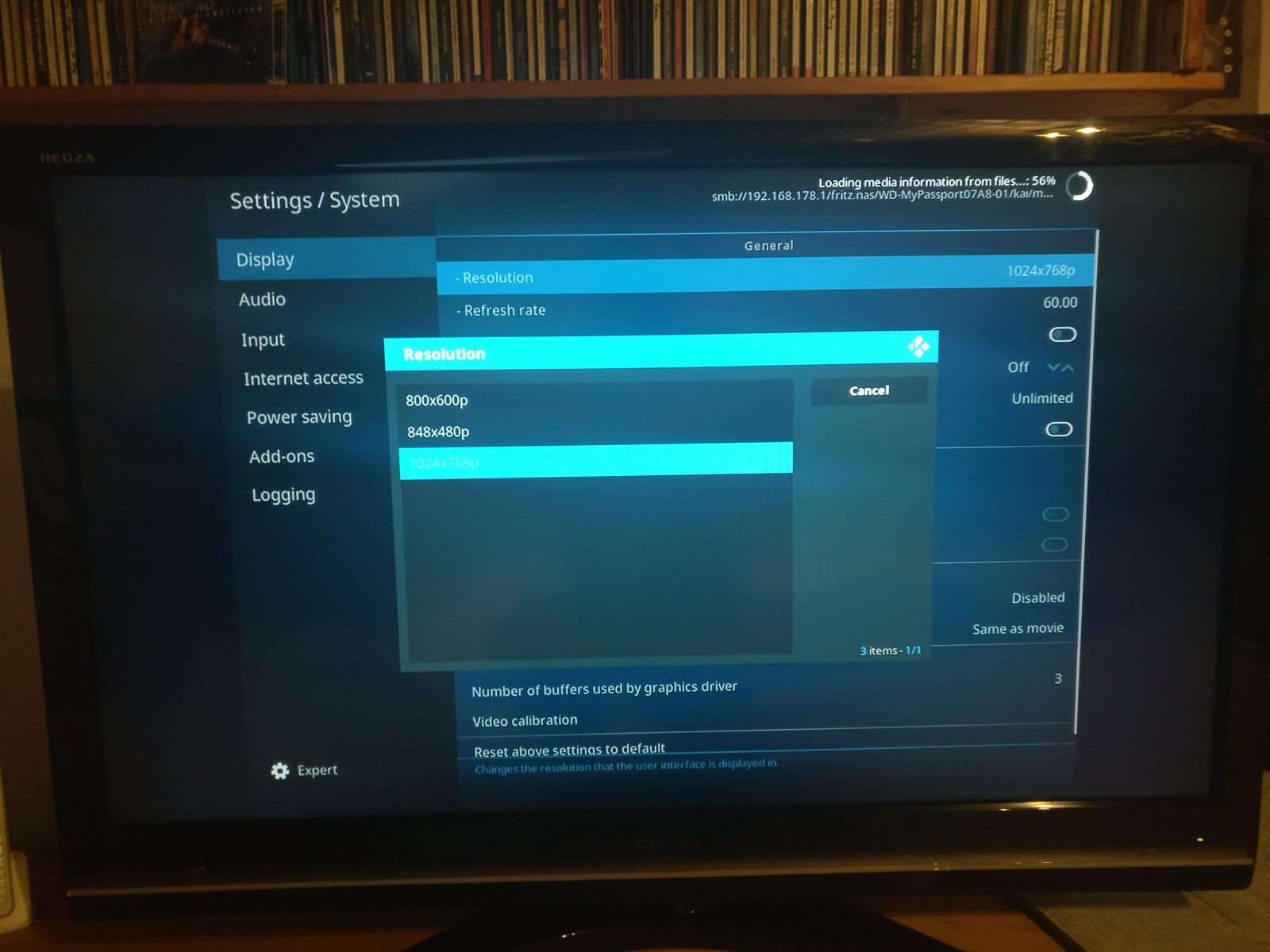

    today I tested an installation of the current L11 nightly on my Wetek Play 2 box.
    1) I have a problem with the resolution. The biggest available resolution is 1024x768. The TV is an older Toshiba HD Flatscreen, supporting 1920x1080 for sure.
    Any idea how I can fix this?

  • 1. Update done, nothing changed regarding the detected resolutions
    I do not know much about how Kodi/libreELEC detect the resolution. Read something about CEC, what is called Regza on Toshiba TV. Regza-Link is on in TV Settings. Not much more adjustments there. TV is from 2009.
    Is there a way to set a specific resolution, if not detected?

  • Run "modetest | paste" and "cat /storage/.kodi/temp/kodi.log | paste" and share the URLs, but the logs will probably just confirm that we don't see normal 1080p modes. You can also try forcing 1080p60 output by appending "video=HDMI-A-1:1920x1080M@60" to kernel boot params in extlinux.conf (on the SD card). This forces the DRM driver to a specific resolution. Resolution is about the modes detected from the EDID data on the HDMI connection, it has nothing to do with CEC. Older TVs are more prone to bad EDID data and that's an era when "HD Ready" TVs with 1080i. Kodi only outputs progressive frames so 1080i will not be selected for output, but those TVs normally have 720p modes that we'd find and use instead. It's always worth experimenting with another HDMI cable and using different HDMI sockets on the TV to see if you get different results.
