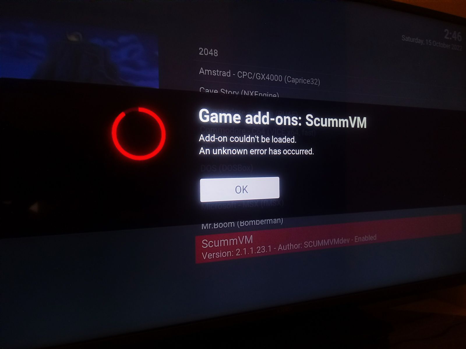

    I am trying to run ScummVM and I am getting this error:
    ScummVM add-on could not be loaded an unknown error has occurred
    I can play other emulators just fine, is there anything I can do ?
    I am running LibreELEC 10 - Kodi 19.4
    Thank you
