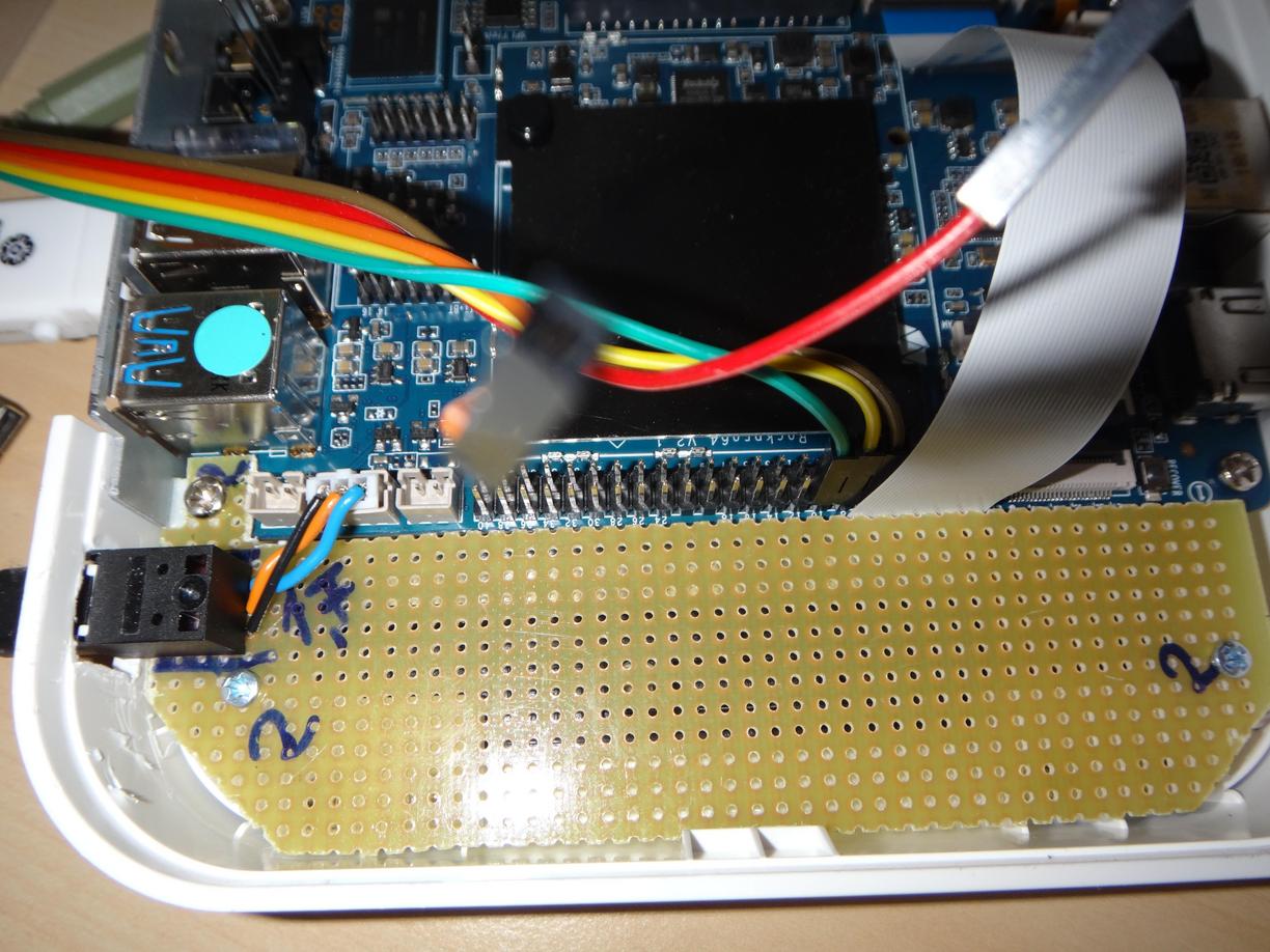

    Just got my Rock64Pro and started it with LibreElec. Still need to connect it via toslink:
    - Looked around to find a vendor for DLT1150A or a similar toslink f.e.m.a.l.e connector, but just found offers for a whole box (2000 pieces) of them. Any idea where to get the connector (from Germany)?
    - Looked at "Audio output devices" in LibreElec and found 4x ALSA (Default: HDMI Analog, HDMI Analog, HDMI HDMI, ES8316 Analog) and a Pulse Bluetooth Audio. Which one would be the right output to get a signal on the SPDIF header?
    Thanks, Chris
    PS: My message contains the censored word "f.e.m.a.l.e" as part of the technical name of the thing one can plug a toslink cable into. I'm not an english native speaker and its been the only translation I found.
    After my cubox is not supported any more I ordered a Rock64Pro to use instead. I need TOSLINK to connect audio and looked around for a solution like for the audio board for the Rock64 that does not work on the Rock64Pro.
    I found the this forum message with a description how to connect SPDIF/TOSLINK to pins on the Rock64Pro.
    Did anybody try this, yet? Is there information whether audio routing with LibreELEC would work through such a connection?
