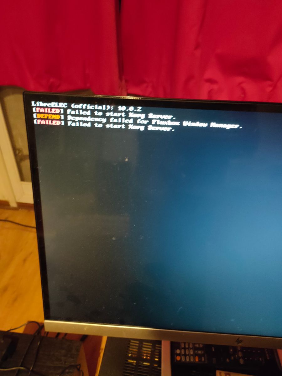

    I get an error stating Xorg failed. I suspect the T400 is not supported yet, as my cpu and motherboard are from 2018 and 2019 respectively.
    How do I solve this? I tried both nightly's of both 11 and 10, and the non nightlies.
    I also changed the bios to accept csm, disabled tpm, disabled secure boot, disabled software guard extension, which made no difference.
    Awaiting your response,

    I think this is the issue:
    0/input28
    [ 7.360156] cfg80211: Loading compiled-in X.509 certificates for regulatory database
    [ 7.370345] nvidia: loading out-of-tree module taints kernel.
    [ 7.370351] nvidia: module license 'NVIDIA' taints kernel.
    [ 7.370351] Disabling lock debugging due to kernel taint
    [ 7.377559] nvidia 0000:01:00.0: vgaarb: changed VGA decodes: olddecodes=io+mem,decodes=none:owns=io+mem
    [ 7.377574] NVRM: The NVIDIA GPU 0000:01:00.0 (PCI ID: 10de:1fb2)
    [ 7.377574] NVRM: installed in this system is not supported by the 340.108
    [ 7.377574] NVRM: NVIDIA Linux driver release. Please see 'Appendix
    [ 7.377574] NVRM: A - Supported NVIDIA GPU Products' in this release's
    [ 7.377574] NVRM: README, available on the Linux driver download page
    [ 7.377574] NVRM: at http://www.nvidia.com.
    [ 7.377605] nvidia: probe of 0000:01:00.0 failed with error -1
    [ 7.377750] NVRM: The NVIDIA probe routine failed for 1 device(s).
    [ 7.377751] NVRM: None of the NVIDIA graphics adapters were initialized!
    [ 7.377752] [drm] Module unloaded
    [ 7.388313] cfg80211: Loaded X.509 cert 'sforshee: 00b28ddf47aef9cea7'
    And no, Nvidia doesn't need propietary drivers with newer hardware, Just newer drivers
