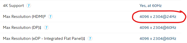

  • Hmm strange yes in the Datasheet it is clearly mentioned... But when you pull up the data sheet of the CPU you can see that over HDMI it only supports 24Hz and not 60hz and the NUC10i3FNHN1 has only one HDMI port: (https://ark.intel.com/content/www/us…o-4-10-ghz.html)

  • I would to suggest to contact Intel to clear both different statements.
    one must be invalid.
    where I tend to what's in the NUC data sheet binds more (in my opinion), but it could be a copy/paste mistake by the data sheet author...
    anyway, two way to go:
    - try with display port (via sorta DP-HDMI-Adapter)
    - exchange the NUC (and before buying: investigate the data sheets to make sure what you'll get)

  • I suspect it is using an LSPCON chip. This converts the Display port output from the CPU to HDMI 2.0 and allows for 4K/60 over HDMI.
