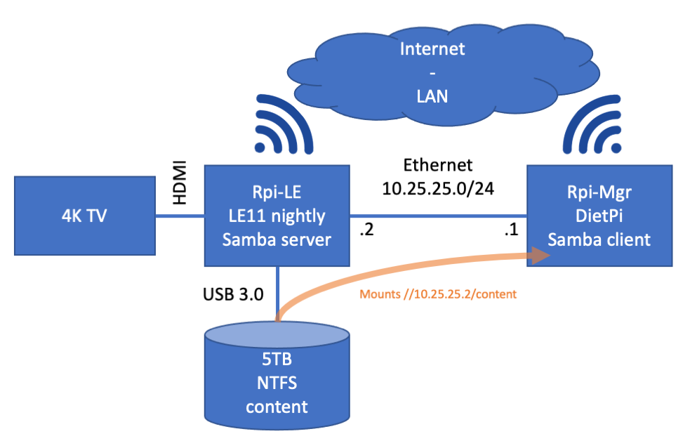

    I run an RPi4 h/w rev 1.5 with LE11 nightly-20220207-72b6d0d (RPi-LE).
    Wi-Fi is used to connected to my home network and the internet. The Ethernet port is used for a direct link to another RPi (preferred technology order changed in connman).
    It has a 5TB USB3 HDD connected to it with single partition formatted in NTFS, mounted by ntfs3g. That hard drive's partition is shared over Samba. The drive's content is 4K HDR videos with HBR audio, directly connected for performance purposes.
    There is another Raspberry Pi (RPi-Mgr), running DietPi, connected to the first using the private Ethernet link, mounting the above shared drive through this link, vers=3.1.1 (tried going down to 2.0 with the same results). This Pi manages the content on the USB hard drive.
    Randomly, and quite regularly, RPi-Mgr reports that the mounted network share stops responding, which creates havoc higher up in the software stack.
    I have tried using a network mount using SMB from my NAS, using the exact same workflow, with ideal results. So RPi-Mgr can be considered fine.

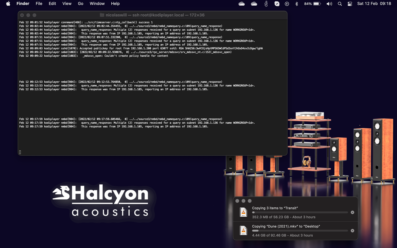

  • UK morning all!
    I have a bit of time to dedicate to this today.
    First, I don't believe that I've ever given the client's mount parameters:
    //10.25.25.2/content on /mnt/content type cifs (rw,relatime,vers=3.1.1,cache=strict,username=guest,uid=1000,forceuid,gid=1000,forcegid,addr=10.25.25.2,file_mode=0770,dir_mode=0770,soft,nounix,serverino,mapposix,rsize=4194304,wsize=4194304,bsize=1048576,echo_interval=60,actimeo=1,x-systemd.automount)
    Who knows why there is an NFS mount option in there (actimeo)...
    The server's parameters are default LE, automatically sharing external discs.
    The gaps in logs were in the Samba logs with Level 10 on.
    Those Samba bugs are not really helpful, but I'm not the best person to judge.
    I'll try to coerce the LE samba to do some client-specific logging and come back here with data.
    [EDIT] It's on and working, giving very dense/verbose logs. How much you want to bet that the error won't crop up for hours, or at least before the /storage partition of my SD card is full?
    Oh, and a last data point, not the smallest: the similar production setup running an LE11 20220120 that I believed not subjected to the issue has displayed the same problem. This is depressing as it removes the possibility of a good known point...
