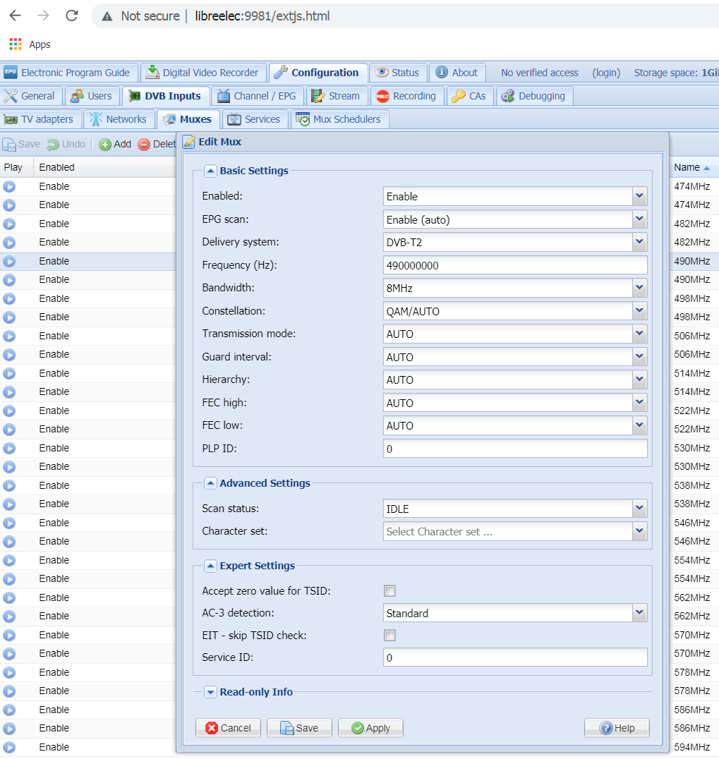

  • It's a questiion how do you have the Astrometa adapters configured in Tvheadend. I would disable the RTL2832 (DVB-T) and Sony CXD2837ER (DVB-C). Keep only Sony CXD2837ER (DVB-T) enabled (it supports both DVB-T and DVB-T2). Reboot and configure / test again.
  • Try to do this settings from scratch, before you search for channels for the first time (uninstall the Tvheadend server Add-on including settings, install it again). Disable the unneeded adapters and perform the MUXes configuration from Tvheadend.
    Consider a manual settings for just the MUX8 as outlined in post #2.
    Create a Network with just that single MUX, set the Frequency to 184500000, then you may need to play with Bandwith (probably 7 MHz for VHF) and Constellation. Then run Force Scan for the Network.
    BTW. you can also try to set the fixed adapter number for Astrometa before you start configuring Tvheadend:
    echo options dvb-usb-rtl28xxu adapter_nr=5 > /storage/.config/modprobe.d/astrometa.conf
    Reboot LE to activate it.

  • @ghtester
    The mux configuration in TVHeadend for PL-Krosno is deprecated, all MUX frequencies do not match and some muxs are not listed there.
    There is no VHF mux8 at all.
    I did a reinstallation of TVHeadend and previously uninstalled the old version and still no VHF support, even manually set mux8 according to the parameters I found on the provider's website. The scan returns an error.
    Maybe this is a problem with the "Astrometa" receiver running under Linux?
