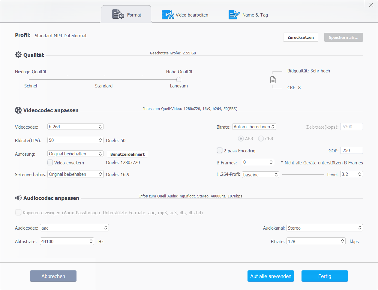

this problem is with all videos and version libre in version 10 (Format all the same, see screenshot). At the moment I have Libre 9.x again in the Raspi and have no problems with audio sync.
Whre can i ndo this: i.e. can you adjust audio offset then "set as default for all files" ?
can you try to remux a video into a mkv (this does not any reencode)?
mkvtoolnix gui is rather easy to use, just remux mp4 -> mkv (~ 1min) and maybe that fixes it
I can remember that buggy mp4 muxers are related to such kind of problems.
