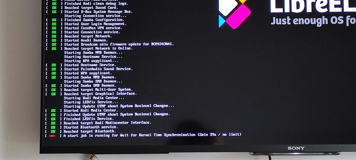

    I've tried to boot LibreELEC on my new Raspberry Pi Zero 2 W, but I'm stuck on boot screen. I've managed to disable quiet mode to make things more verbose and the following line seems to be the culprit:
    "A start job is running for Wait for Kernel Time Synchronisation" (photo in attachements).
    I've waited several minutes and ended with nothing.

  • LE11 nightlies are the only images that will run on RPi02W hardware (without a lot of jumping through unsupported hoops) .. but you'll likely run into a bug that will stop Kodi from running in the latest nightlies. The issue is known, but needs some dev attention to fix, and the devs in question (from RPi Foundation) are on PTO at the moment. So be patient and wait a week and it should be resolved. NB: RPi02W only has 512MB RAM so while it can/will boot LE11 nightlies we have no plans to formally support it (or any other 512MB devices) as Kodi Matrix/Nexus really need 1GB.
