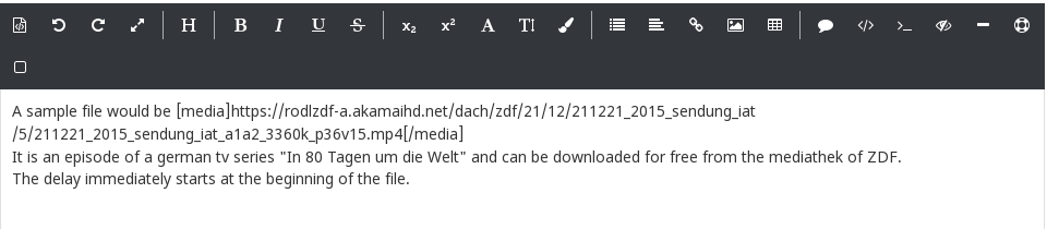

A sample file would be https://rodlzdf-a.akamaihd.net/dach/zdf/21/12/211221_2015_sendung_iat/5/211221_2015_sendung_iat_a1a2_3360k_p36v15.mp4
It is an episode of a german tv series "In 80 Tagen um die Welt" and can be downloaded for free from the mediathek of ZDF.
The delay immediately starts at the beginning of the file.

I put a link in my message:
Don't know why it is not showing
So I give it another try:BTW: The same file plays fine with an Raspi 3 and Libreelec 9.2.8 ...
Link gives access denied.
For me, the link works:
