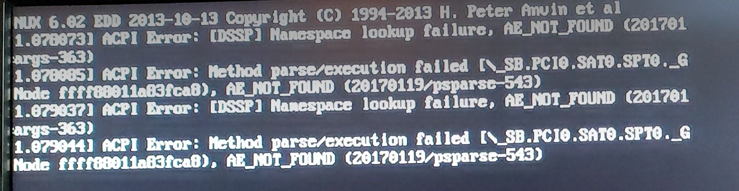

    Yes, there was OpenELEC -> LibreELEC update before, so I tried to change the partition size : I used rufus to create a bootable USB thumbdrive with Gparted Live image on it, but it doesn't boot. I followed this video https://www.youtube.com/watch?v=1E5_tCkzuVQ but when I choose the USB thumbdrive to boot, an error appears for less than a second:
    LE then just boots as normal to 8.2

  • How can I boot from the USB Drive? LE does not allow to me to boot to either gparted or the LibreELEC.USB-SD.Creator.Win32 10.1 image.
    Your BIOS decide what to boot. Try to change boot order (you can even disable HD boot), USB connector, USB stick, loaded image ... until it is satisfied.
  • Thank you MatteN, CvH and mglae ! It worked perfectly!
    I installed Gparted Live on the USB thumbdrive. I pressed delete to get into the bios of the machine, and chose to boot from the USB thumbdrive. I used Gparted Live to increase the size of the partition to 512MB, then rebooted the machine from the main SSD drive. From within the LIBREELEC CONFIGURATION add-on I chose the 9.0 Update channel and updated to 9.2. I rebooted the machine and then did the same to update to 10.1.
