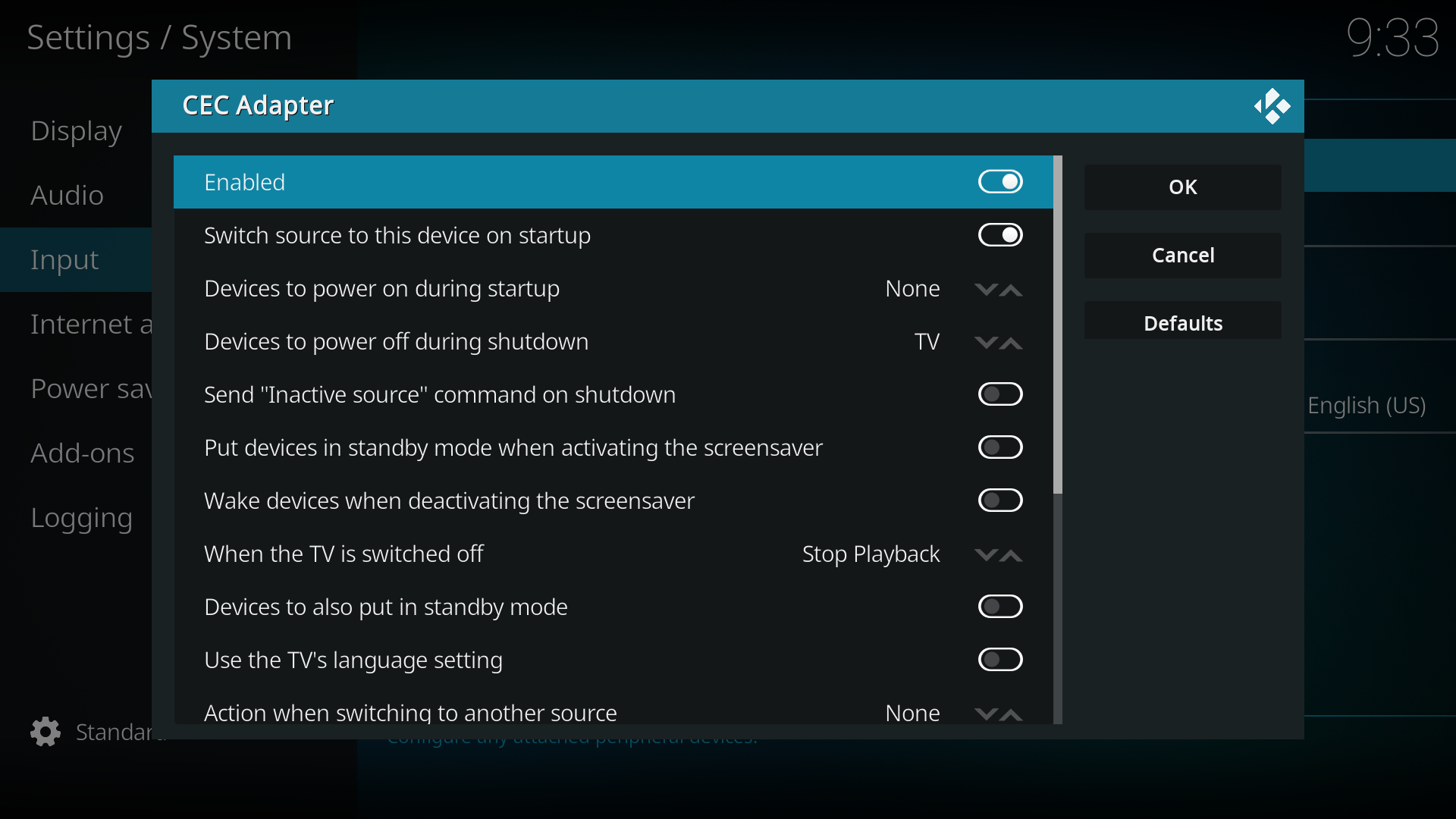

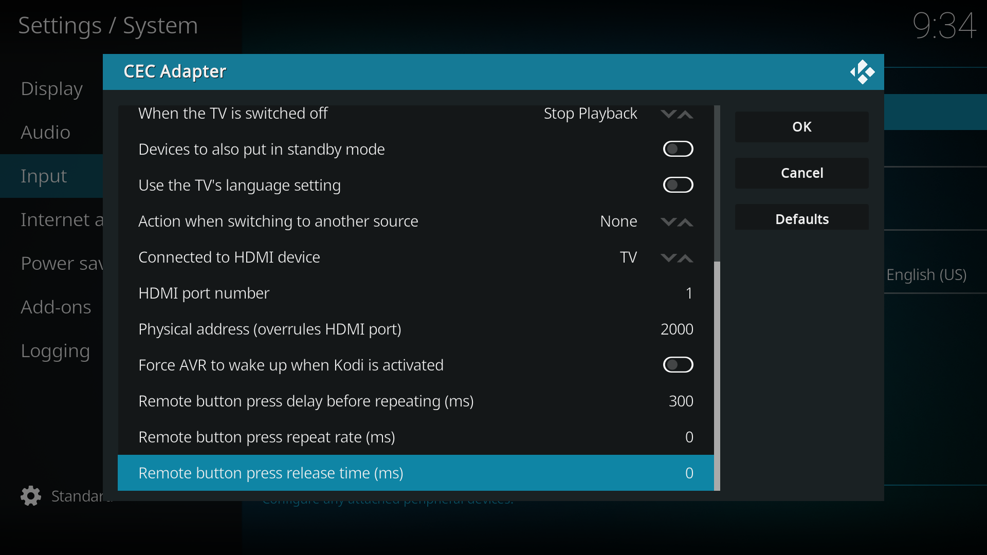

    I am attaching CEC log and CEC settings. Should be CEC settings changed in 10.0.1 to achieve the same behavior as in 10.0.0?
    Thank you.
    cec_debug_log.txt
