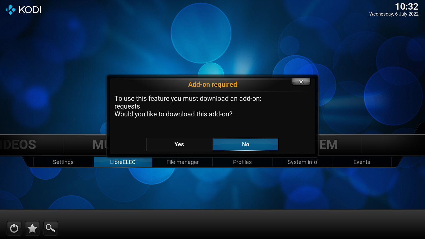

  • Tqdm is a python library for progress bars, nothing more.
    The requests library exists as a kodi addon in the main repo, so you can just ssh the libreelec system and run
    kodi-send --action="InstallAddon(script.module.requests)"
    A prompt will appear on kodi, as shown in the screenshot below, so you just press yes there.
    The reason for the above is that, since kodi 17, search does not return results for addons of the "script.module.*" family. If it did, you could just search for it from within kodi and install it as any other addon.
  • Nothing happens when i use that command at ssh terminal, but I already have requests installed.
    I can confirm it is an installed dependency for some addons I have installed. I do not see a way to install it directly.
    In fact, searching for addon called "requests" causes Kodi to crash, but searching for other addons does not. I think that is a bug.
    About that. Yes, kodi will not show the dialog box if the addon is already installed, even if it is installed and deactivated. It will just ignore the "request" to install it.
