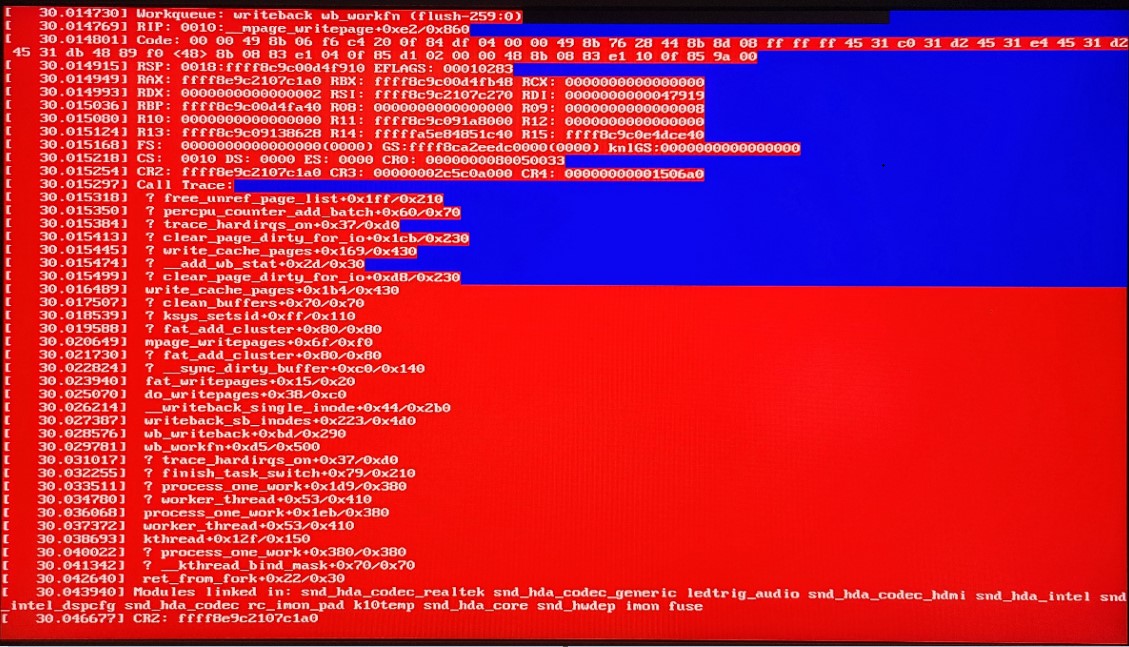

  • Hi All so I tried this back a while ago when it was RC and though maybe it would be fixed by now.
    When starting a new install from USB with a freshly DL Image LibreELEC-Generic.x86_64-10.0.0.img.gz
    I get a redscreen you see below:
    My Machine is running B450M Pro4 P4.30 board with AMD Ryzen 5 2600 six core processor, 32 GB of DDR-2133 ram (2x16GB sticks)
    and a Gigabyte GeForce GTX 1050 Ti OC Low Profile 4GB GDDR5 128 bit PCI-E graphics card
    Prior version of OS ran perfectly no issues
    Hope some one can help
    Mark
  • It's crashing while writing to the FAT FS. But there is no obvious error source visible.
    1. Have you already tried a different stick on a different USB port?
    2. You can test if a more recent kernel does behave better by booting a LE11 nightly from test.libreelec.tv. Do not install, LE11 is to unstable for daily use.
    3. For BIOS update 5.20 one description is "Improve USB compatibility", but I really do not like recommending BIOS updates.

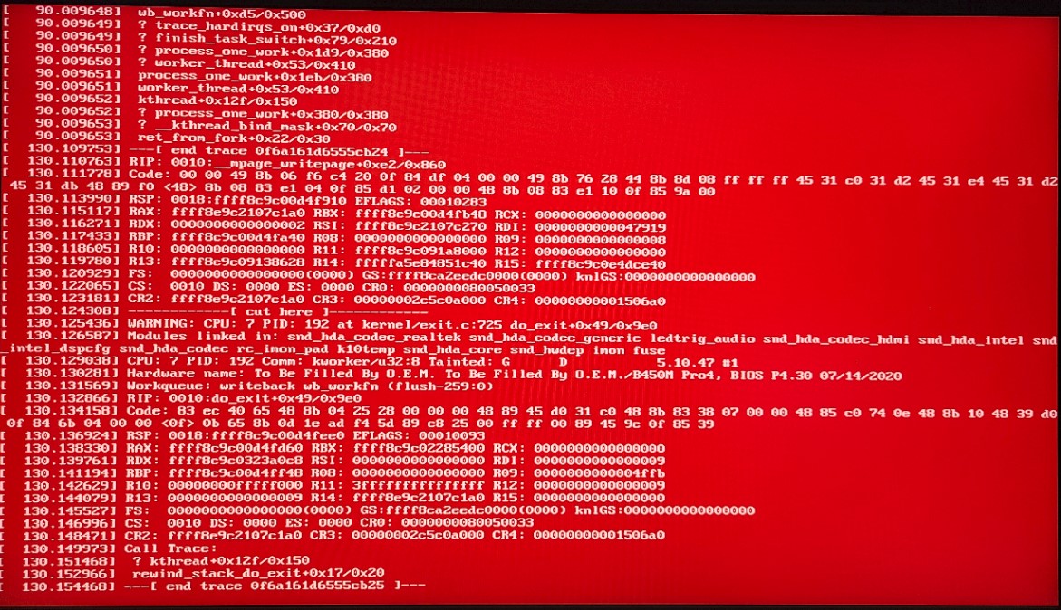

  • Hi and again thanks for the qucik response.
    I even tried originally to do an upgrade and it get the same issue...
    Tried diferent stick, 3x different ports no success.
    Bios is at most current for recommended Processor type.
    Tried the nightly LibreELEC-Generic.x86_64-11.0-nightly-20210923-7455a76.img and get the exact same error gets to like 65% on the install
    its strange as i can install the LibreELEC-Generic.x86_64-9.2.6.img.gz with out a hitch :)
    Love the product been using it since 2013 keep up the great work, this is a brand new box build all new hardware so it perplexing why the 9.2 installs fine and this does not

  • It must be the MoBo/CPU AMD combo as I even tried putting in a extenal SSD instead of using the MoBo m.2 and stilled failed
    Agree.
    Maybe there are warnings/errors in the kernel log. Boot into installer, press <Alt-F3> to get the debug console and type:
    mount -o rw,remount /flash
    dmesg >/flash/dmesg.txt
    poweroff
    Put the file to a pastebin site and post the URL here.
    As a wild guess: we did enable IOMMU support in the kernel at some point. You can try amd_iommu=off kernel parameter to disable it.

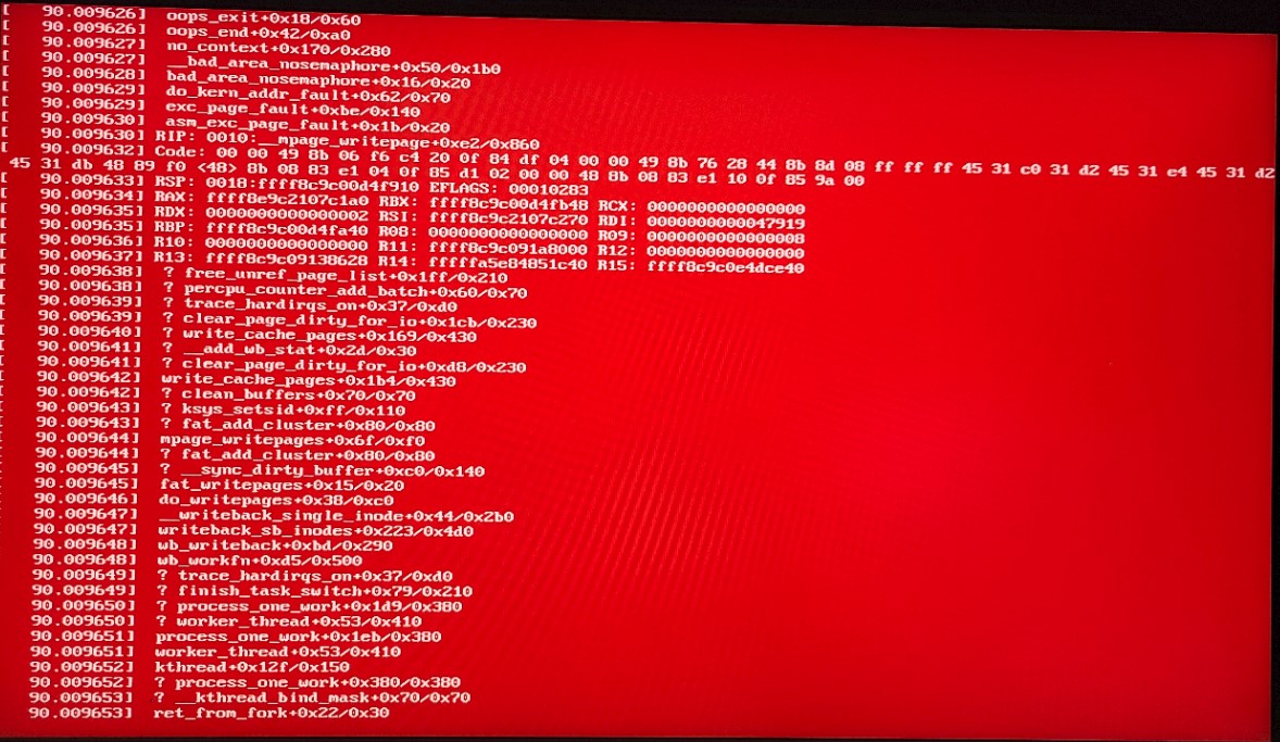

  • Unfortunately there is nothing visible in the log.
    There is still the pause_on_oops=100 parameter in the Kernel command line, you can remove it now.
    amd_iommu=off is missing. Did you try it? (I'm getting out of ideas).
