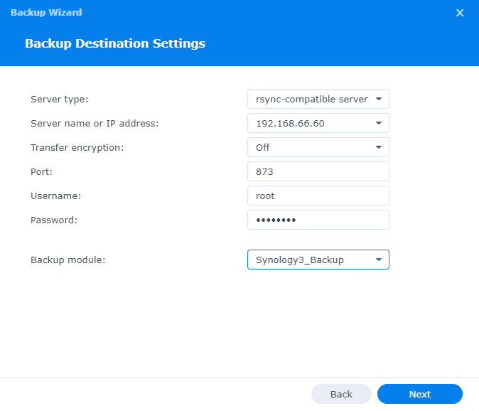

    When the Server (Synology NAS) connects to the client (LE 10.0) I use root/libreelec credentials to connect.
    After that I needed to select my rsync module ... and from pop-up windows the right rsync module is shown and i can select the module as well.
    In case of rsync issues or in case of connection issues ... The pop-up window would be empty ... So it's working !!!

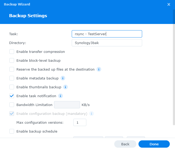

    After selecting the rsync sources for backup I need to save the configuration and I should be able to run the first test.

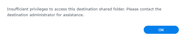

    But unfortunately after pressing the save button and error message appears ...
    "Insufficient privileges to access this destination shared folder. Please contact the destination administrator for assistance"
    This is due the fact that the rsync process will create the destination share and store its rsync notes (synobkpinfo.db) inside.
    Again .. all the same in LE 9.2.6 (working) and LE 10.0 (not working).

  • But unfortunately after pressing the save button and error message appears ...
    I've no idea from that tool running on your NAS.

    the password in the first picture is "libreelec" and the IP adress matches ?

    it seems the second picture is uncomplete.
    Sorry, no more options. Just the setting to configure the scheduler ...

  • Okay, I post the rsync logs for two different systems ... one with LE 9.2.6 one with LE 10.0 ...
    As a workaround, can you set in your rsyncd.conf:
    use chroot = no
    And see if that makes any difference?
    Edit: Looking at the Fedora bug, it looks like "use chroot = yes" is the workaround. It's kind of confusing the way it is worded. But try both, I think "no" is the right option based on the Ubuntu description of the issue. My guess is this option is "yes" by default in rsync --daemon.
    Edited 2 times, last by frakkin64 (September 22, 2021 at 1:14 PM).
  • Wow ... thats the solution ...
    use chroot = no (in Module section) works !!!
    this is my updated rsync.conf ...
    list = yes
    port = 873
    log file = /var/log/log.rsync
    timeout = 300
    [Synology3_Backup]
    comment = Synology3 Video Backup
    path = /storage/videos/
    max connections = 0
    use chroot = no
    read only = false
    hosts allow = 192.168.66.251
    uid = root
    gid = root
