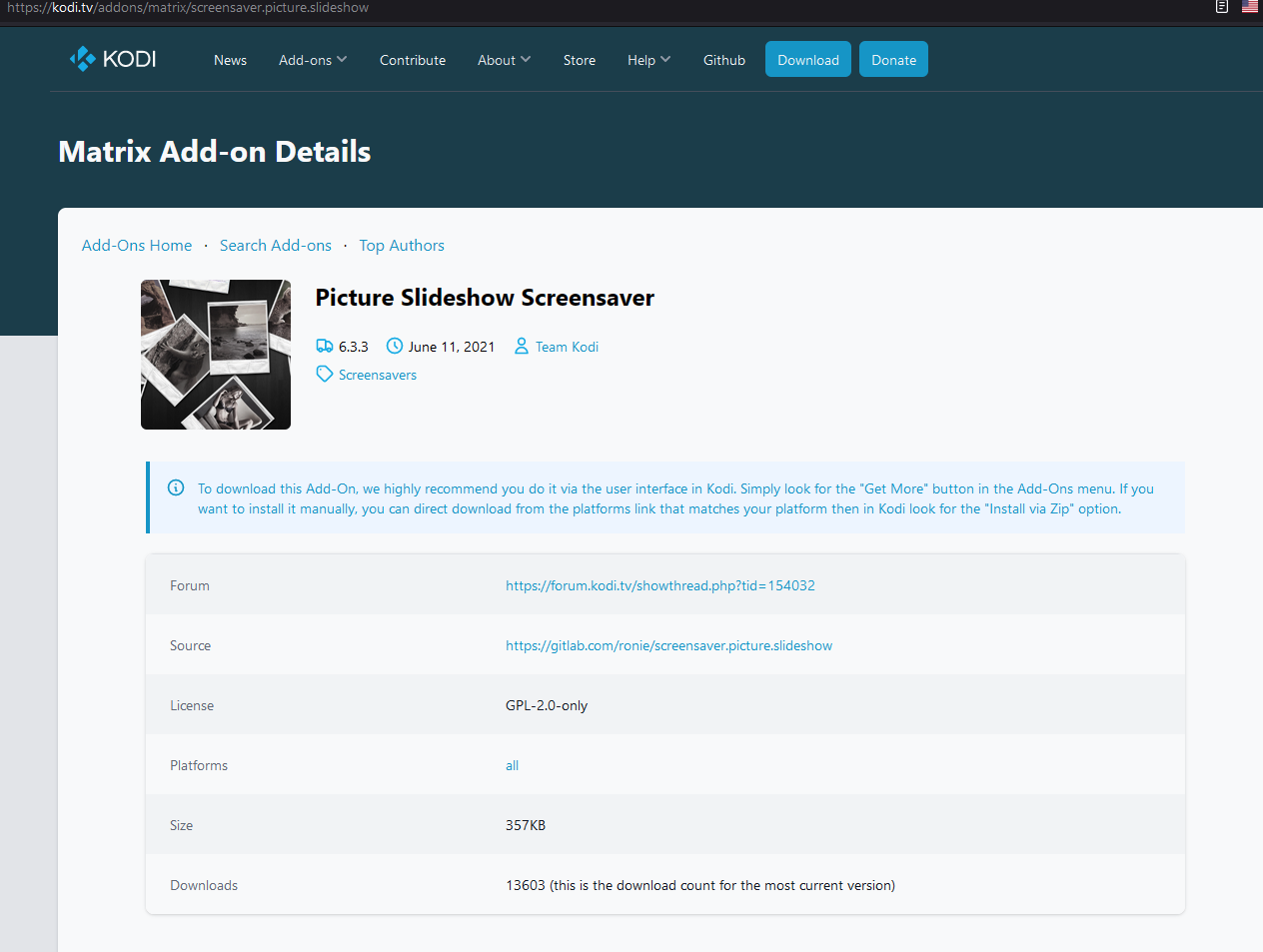

  • I've just looked and I do not see this add-on in the Kodi repo.
    Thanks for yor reply! I found it here (under matrix add-ons):
    Im not shure, but this (kodi.tv) isn't "official"? I thought it is..... Or did you refer only to the LE rep?
    Thanks for your answer! :)
    R.
    Edited 2 times, last by MacNoname ().
  • Ahh, it's under screensavers. I looked under picture add-ons. See if installing/setting a German locale (use the locale add-on in our repo) makes any difference. If not, post the problem to here: Picture Slideshow Screensaver which is the authors support thread in the Kodi forums.
