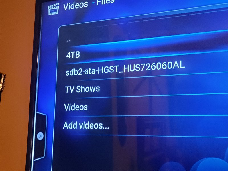

    Minor:
    I would like to rename the 4TB and sdb2 blaa blaa.. But the dirs are not able to be renamed, either in Windows File Manager or directly in the LE box via SSH...
    Which I think is caused by my MAJOR problem..
    I can't write to the drives... In SSH, the dirs in /var/media/ are all drwxrwxrwx but the files themselves are -rw-r--r--
    I have tried every mount, remount, umount, chown, chmod known to humans and I can't change the permissions..
