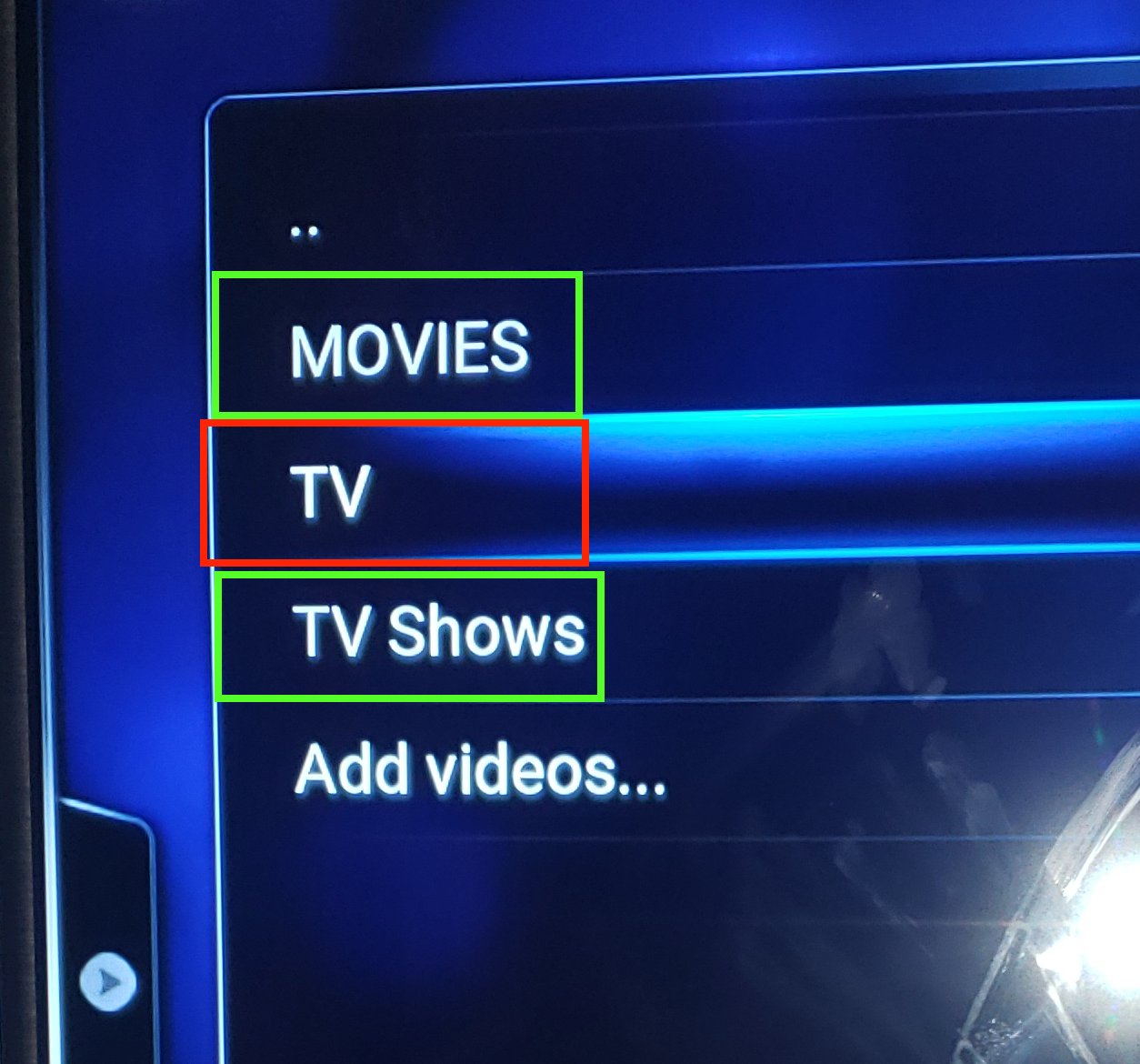

    I have gotten my MOVIES and TV files situated and recovered..
    I wanted to re-do the KODI directory structure...
    I created the links I need:
    The dirs in green are the new ones. They are based off the TV dir. I want to delete the TV dir, but without removing the CONTENT of the TV dir..

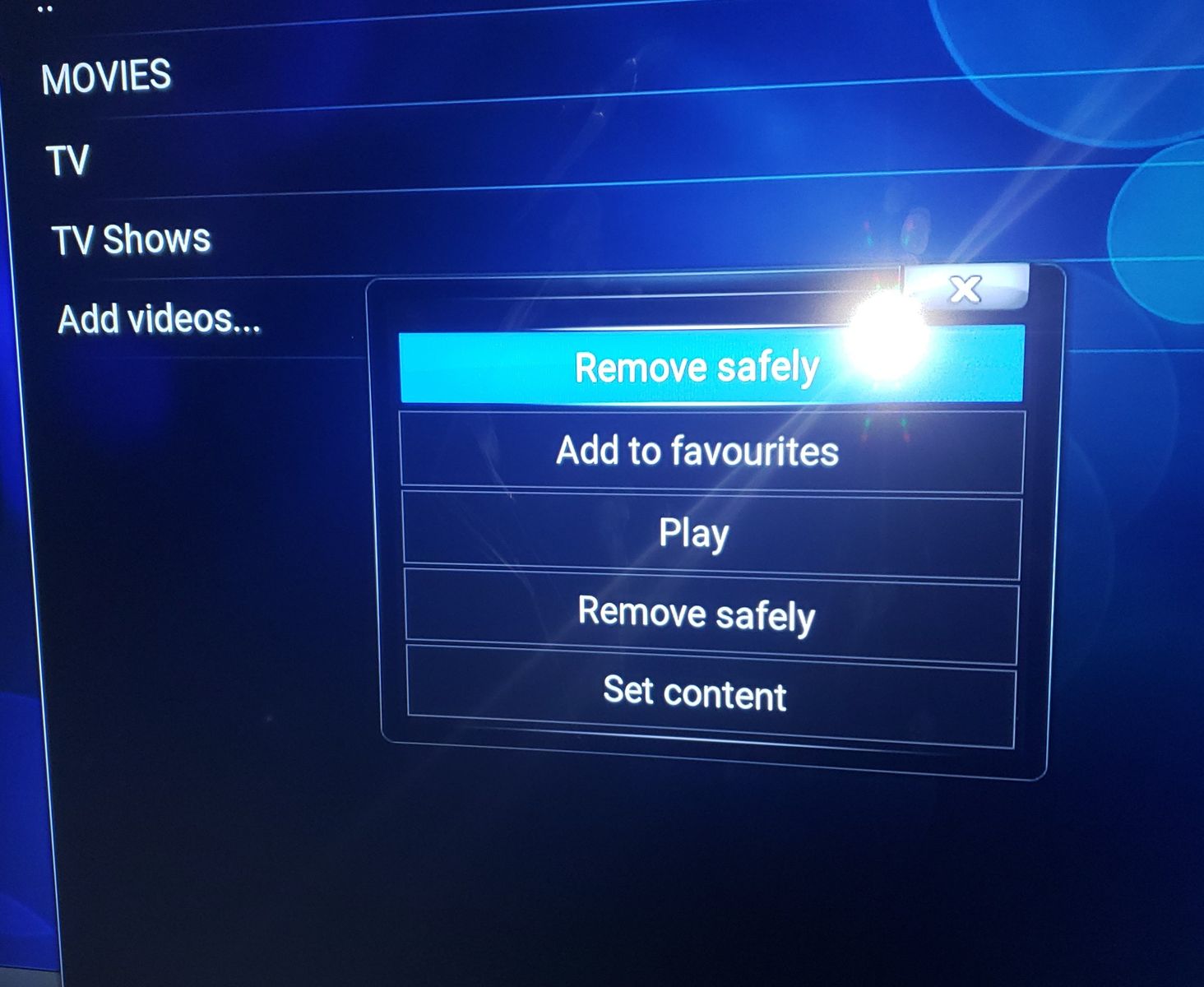

    I am assuming that if I use the REMOVE SAFELY, that will simply remove the TV from the KODI screen but will not touch the content of that dir..
    First I want to confirm that that assumption is correct.. Because everyone knows what happens when you make an assumption.. You make an ASS out of U... and umption.. :D
    Secondly, I want to confirm which REMOVE SAFELY I should use...
    As always, thanks in advance for all the help.. :D
