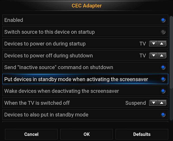

  • Does CEC work with your TV? There is an option to put devices in standby when the screensaver starts.
    Unfortunately, it doesn't seem to work with Black\Dim screensaver modes.
    My mistake, is DOES work with Black & Dim modes. :)

    This is pretty much what I do.
    I have the power button on my remote mapped to active the screensaver in remote.xml
    <keymap>
      <global>
        <remote>
          <power>ActivateScreensaver</power>
        </remote>
      </global>
    </keymap>
    Then in CEC settings I have the setting to turn off the TV when the screensaver is activated.

    I have not been able to get my tv to trun off via cec
