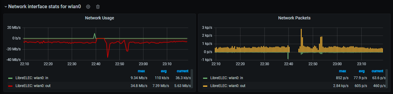

  • Yesterday evening, at 21:10 CET, a Scheduled Recording started on my TvHeadEnd server and at 22:39 I decided to watch a Recorded Video (a different one, though this is not important). At 22:43 the Wi-Fi stopped working.
    The sequence is the following:
    I do not understand how I can lose connectivity on my loopback, though.
    I was pretty sure that my recording would fail as well, and instead, surprisingly, I haven't lost any packets at all, even while the wifi was out. If you look at my grafana, you'll notice TVH or Kodi cached the data and then sent them all as soon as the WiFi was re-established (I did tweak the advancedsettings.xml). Actually I do not have any issues in playing HD Video.
    My settings are the following, and I am using buffermore=4 to cache NFS as well. Odd enough, I am using exactly the same memory size you are using!
