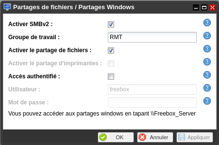

    But I still fail to configure kodi after switching my freebox this monday to SMBv2. I can still access my SMBv2 share from my main linux workstation (cifs mount share), so the switch was rather smooth. But for some reason I am missing something on RPi3b+ side.
    Here is what I have in /storage/.kodi/userdata/sources.xml (everything is pure ASCII):
    <source>
    <name>musicvideo</name>
    <path pathversion="1">smb://guest:guest@FREEBOX_SERVER/Freebox/musicvideo/</path>
    <allowsharing>true</allowsharing>
    </source>
    I picked 'guest' / 'guest' since I do not use account/password in my configuration:

    My goal is to avoid going back to the old SMBv1 protocol so that my work laptop (windows 10) can access my freebox share drive.
    I have also tried setting min and max SMB protocol in the Kodi UI (currently SMBv2 as min and max).
    What should I try next ?
    Thanks

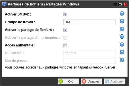

    Thanks for the support. So I did setup a simple freebox/freebox credential, reboot the freebox (mini 4k) and updated on the kodi side with:
    <source>
    <path pathversion="1">smb://freebox:freebox@FREEBOX_SERVER/Freebox/musicvideo/</path>
    </source>
    I rebooted the kodi system (LE 9.2.6). And looking at the kodi.log file I still see the same message:
