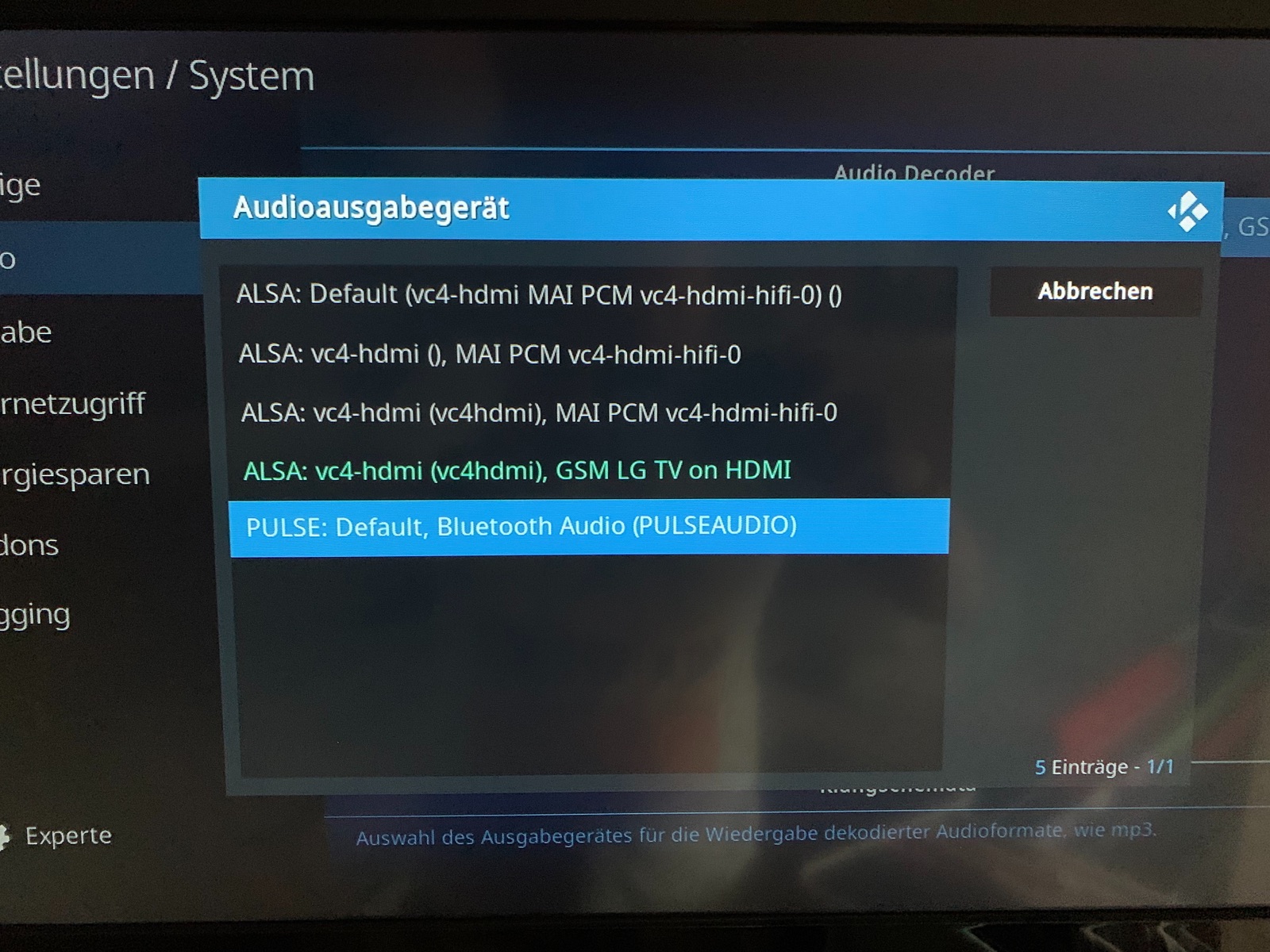

i have now spent 2 days trying to get analog audio for LibreElec 10 with no success. There are only 2 options, either go back to LibreElec 9 or throw my Sonos 5 (first edition) in the trash for about € 500,00.

Post 2 does not work, an analog sound is not offered under System.

Of course it works in LE 10 (tested on latest Nightly build) if you edit the /flash/config.txt properly and set the Audio output device in Settings - System - Audio menu to ALSA:bcm2835 Headphones, bcm2835 Headphones
hey i have a pi3 with night 10 with me there is no way to activate it tried everything my hope is on popcorn that he still has a solution ...

on x86 it works with me also have now tried it on 4 pi3 b + no changse with osmc it works and other builds also only with the 10 it doesn't work which is of no use to me but libreelec because of my touch it only works with it
