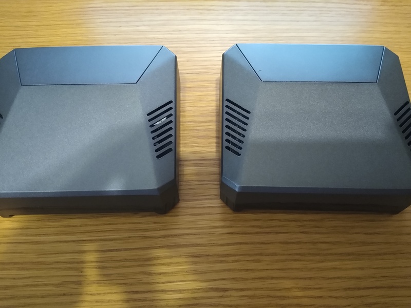

  • Further.
    I just upgraded two identical devices to v10.0b1 with the argon utilities, mysql, etc.
    The first installed exactly as expected and operated perfectly from the first boot.
    The second would reload Kodi when I try to play any video file. This behavior stops when I remove the tag </advancedsettings> from the file: /storage/.kodi/userdata/advancedsettings.xml. The first box works fine with this tag in place. Both were created from the same downloaded image and there is no difference in hardware.
    Very odd.
