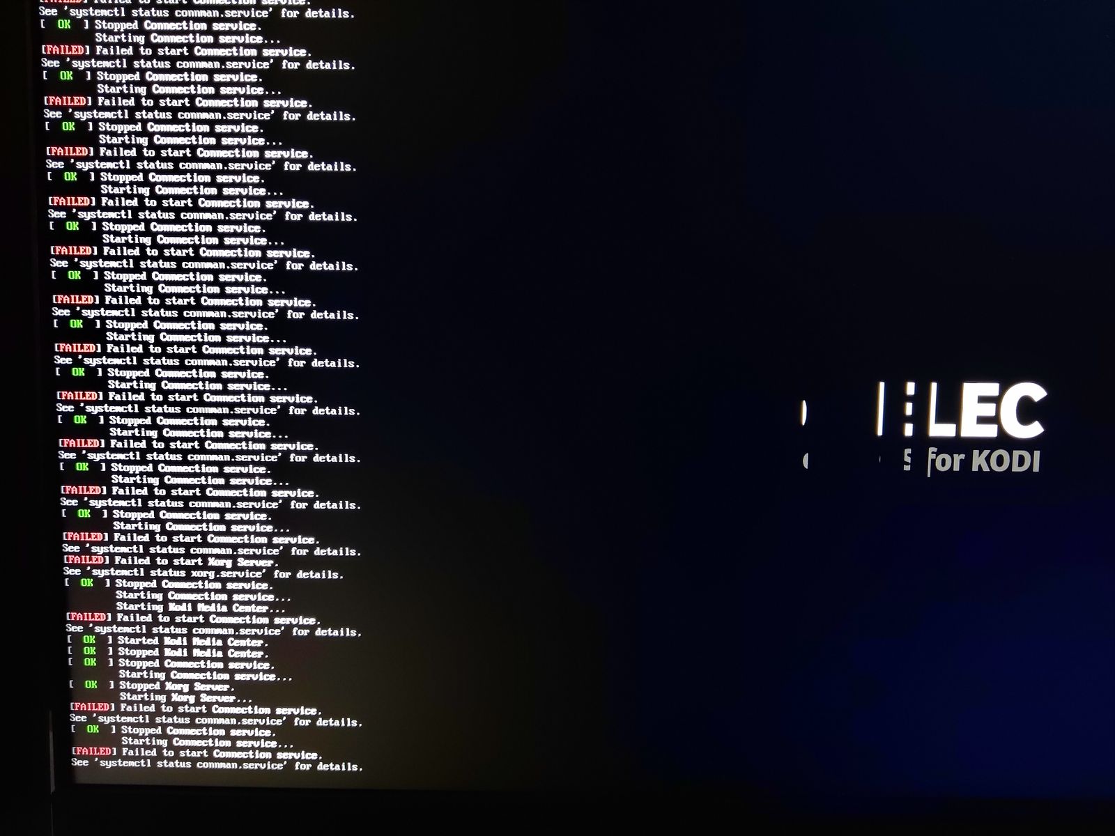

    Now during boot up, it hangs on this error...over and over till it fills up the screen and just keeps going till I manually shut down the pc. I tried running it from the USB stick 'live' or 'run', same problem.
    [ok] stopped connection service
    starting connection service
    [failed] Failed to start Connection Service,
    see 'systemctl status connman.service' for details
    And those lines just repeat over and over.
    I have no clue where to look for any error log since it's running from the usb (even though I did install it to the hdd). No other OS is on the hdd.

    Please try installing/running the LE10 beta release.
