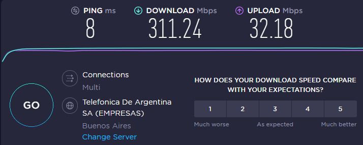

As I told you, this does not have to do with interference and 2.4ghz bands since in my router I have an option to "scan" the other nearby wi-fi and see what channel they are on, yesterday I put my wifi on a channel that does not It was in use by nobody (neighbors), with the same usb extender I put the antenna literally 1 meter (3.3' feet) from my modem / router and the speed it received was the same (maximum 20mb) the antenna picks up and supports up to 150mb and my internet ranged between 300 and 320mb so if I would be receiving half of that I would be more than satisfied, I would be more than satisfied honestly, even with only 50mb.
Nor is it the wifi antenna since testing on a windows pc the mbps it receives is much higher (from 30 to 50mb)

My ethernet speedtest : -
