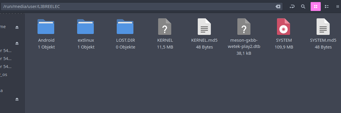

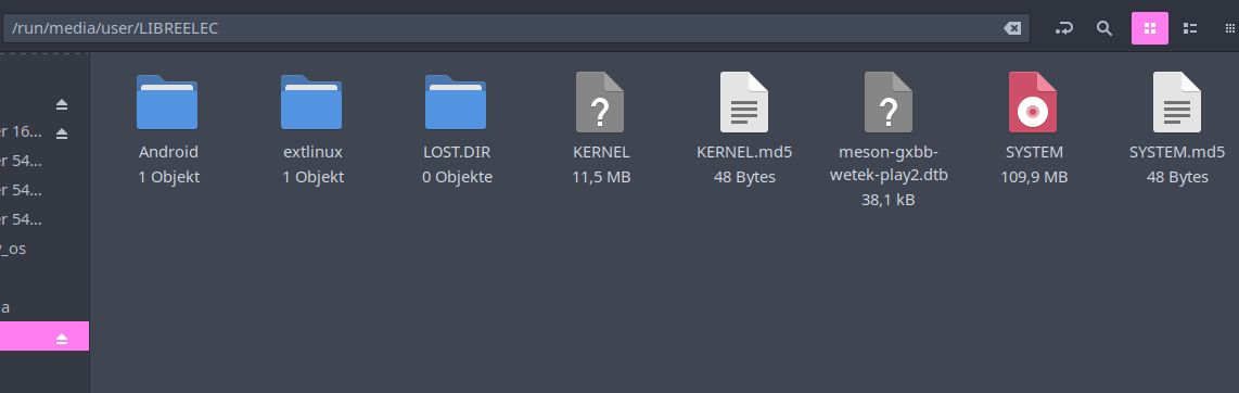

  • The Wetek-Play boots with the box image, but the image on the monitor has greenish diagonal stripes. Nothing is recognizable. Same thing on another monitor.
    Edit: found it with reading the whole thread once more: name-variable ...
    Now the Box starts. If I see it right, there is no driver for DVB-device within the box-image?
    help me friend i m here as u said..greenish diagonal stripes...how do u overcome this issue..i rename uEnv.ini file like this
    dtb_name=/dtb/meson-gxbb-wetek-play2.dtb
    now its booting but as u said nothing is recognizeable.
    @@ these 2 sign should be remove or not?(in the begining and in the end )
    and for edit file any specific tool or we can edit with notepad or wordpad?

  • The second partition on the SD card is designed to self-resize on first-boot so there is no need to "fix" this non-problem. Just create an SD from the box image and set the dtb name in uEnv.ini .. and that's all to do. As per the Amlogic page in the wiki; do not rename dtb files to dtb.img; do not change the location of files.
