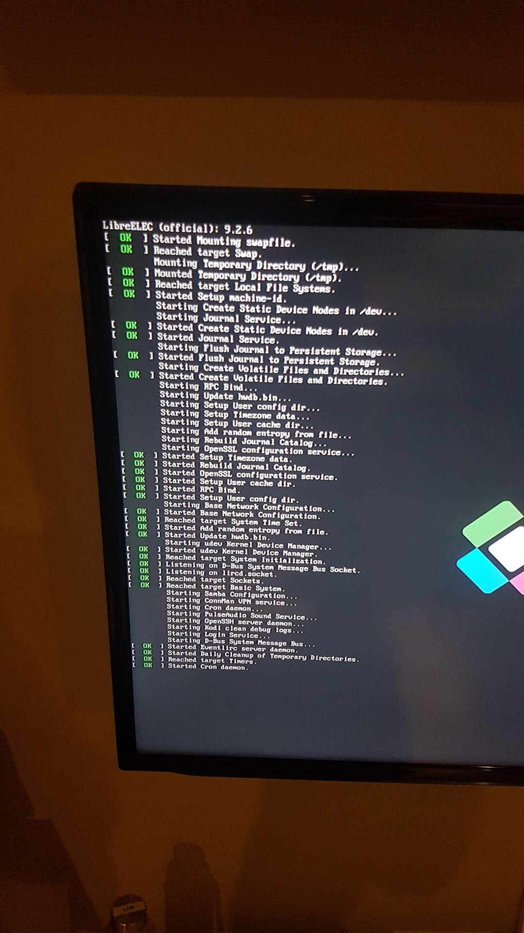

Heheh, sorry, thought it was an only software question. I have an Asrock motherboard with Intel j1900, 4gb ram and 1tb HDD.
And I'm running libreelec 9.2.6 generic x86_64

The J1900 was a board that had/still has(?) a kernel bug problem. I'm not sure if that is still a thing.
Can you rename the .kodi folder to something else, and reboot LibreELEC for a clean setup?
And perhaps also try a testbuild?
Yes, you were right. Renaming .kodi folder system boots fine... but I lose all my configuration. And it took me too much hours! Is there any other way that I could find which element is interfering in every restart? I can not conceive of configuring everything from scscratch
Thanks
Tried downgrading to 9.0.2 version and boot is normal in that version. But when upgrade back to 9.2.4 or 9.2.6 have the same problem again in every boot.
