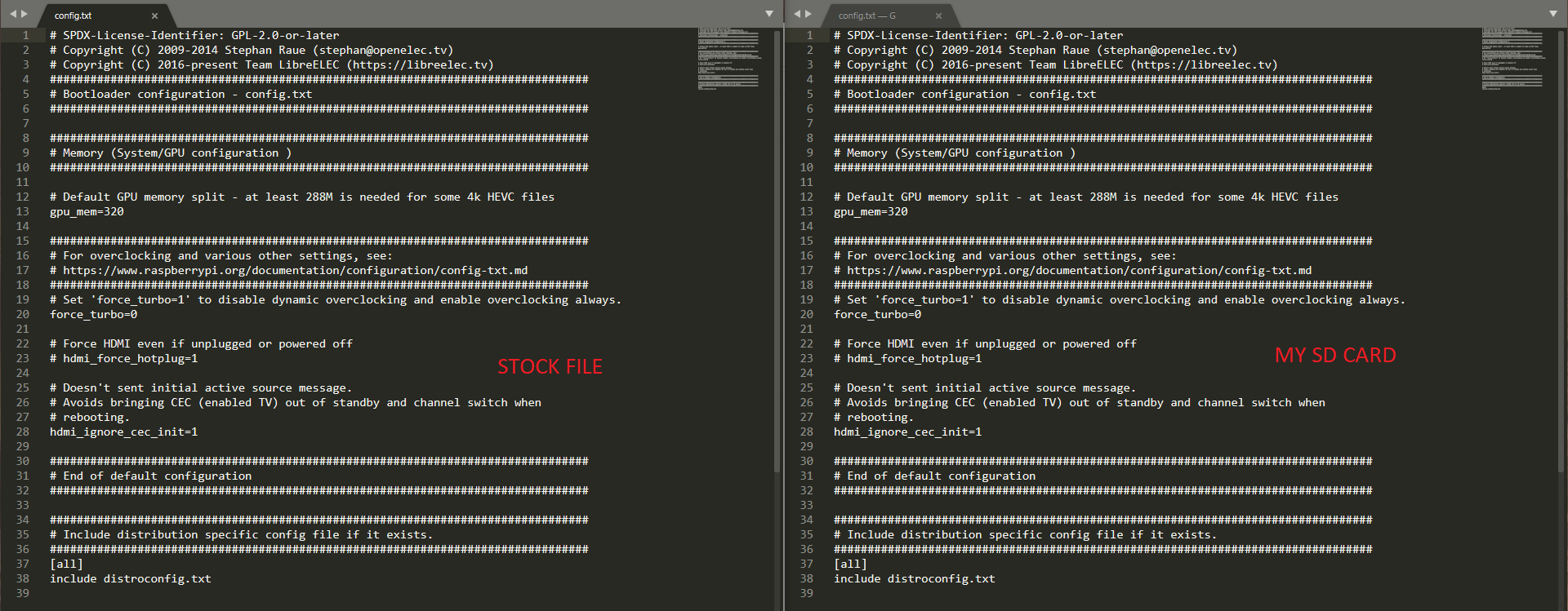

  • Is this an installation with added/changed settings in the config.txt file. Try starting up with the default config.txt file.
    Also, try a fresh install anyway with the default English language setting (I know, you French, hehe...), but it could be a language setting problem.
  • Thanks for your help :)
    I already tried to start from fresh install on brand new SD card, but problem is same : ok for first boot, but if I shutdown my system, it doesn't start : stuck at "Librelec 9.2.6 (official)"... :(
    My config.txt is the same as original :

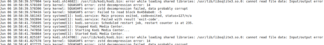

  • Same problem here for the 3rd time:
    • LE 9.95.3 in a RP4 4GB
    • Stops with "LibreELEC (official): 9.95.3" in the upper left corner and the splash screen.
    • SSH working, can reboot, but it will stop at the same state
    • If I viw the logfile, I see masses of this error:
