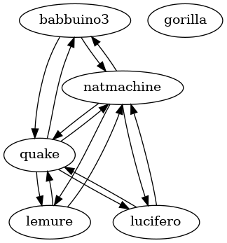

  • Can you see route to 10.9.0.0/32 network?
    That part looks ok (10.9.0.1 is natmachine, 10.9.0.3 is quake)
    And attached is the network as I see it from lemure (my laptop, 10.9.0.2) -- gorilla is currently switched off
