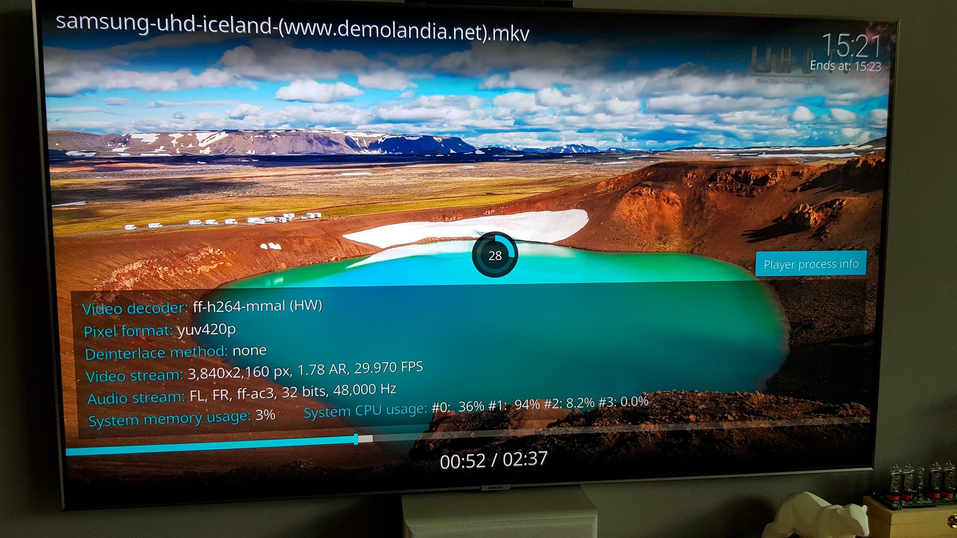

    When started via Kodi it stutters. When I call the on-screen info (see attached picture) it seems to me that Kodi is transcoding this video since one of the cores is running at 100%, all the time.
    Why is Kodi doing this? It should be a supported resolution right?

  • it seems to me that Kodi is transcoding this video since one of the cores is running at 100%, all the time.
    codec info should show if hardware decoding is active?
    looks like it doesn't on your setup...it probably depends on what skin you r using..
  • H264 hardware decoding is only supported up to HD resolution on RPi0-4. Only HEVC works with hw decoding of 4k files on RPi4.
    But keep in mind that some of the high-bitrate 60fps HEVC demo clips won't play smooth (this is a known issue), standard 4k 24-30fps files should be fine though.

    Ah, ok I did not know that. I will test a bit more than, looking for HEVC H265 encoded content.
