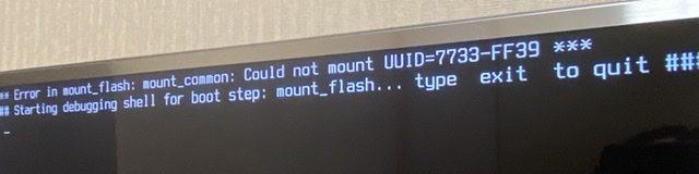

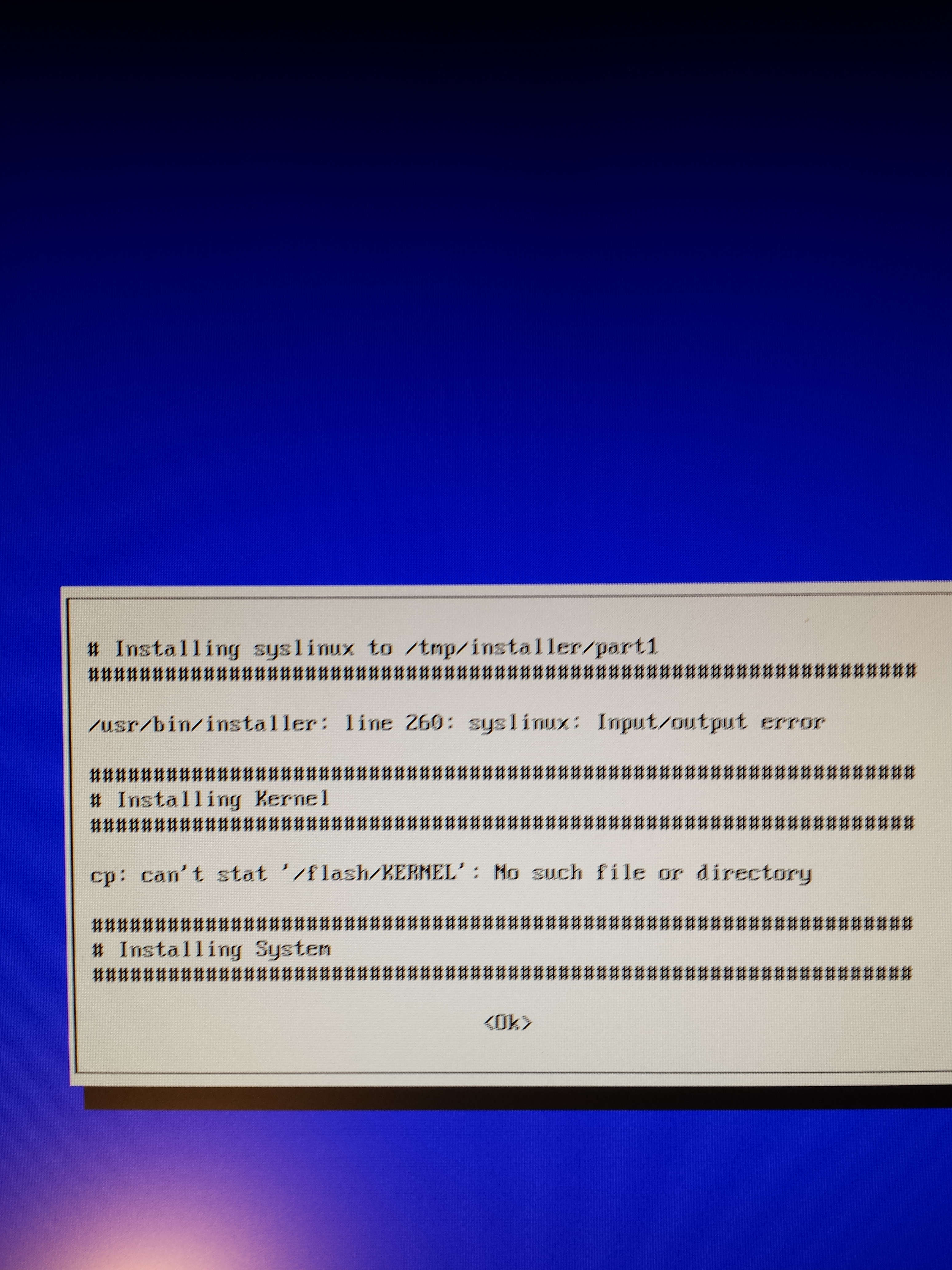

changing the usb port during install brought up the usb stick as install target and nightly was installable, but a subseq. boot runs into an debug shell (see attached photo).
Edit:
investigating the stick after install turns out there is nothing on /storage

investigating: turns out that the LibreELEC USB-SD Creator from here:
LibreELEC Downloads – LibreELEC throws some I/O-errors during installing on the stick.
- alas "save log" saved it somewhere, but not on the stick... -
compared the md5sums of the Creator on my box and from the website: checksum are equal.
moons ago I created with an (/this ?) Creator the same stick with Release LE 9.2.2 or .3 and updated to Milhouse nightly without errors...
confused !
hint:
the checksum of one of the Kernel or the System after the Creator action and after install on the stick do NOT match !
is this normal ?

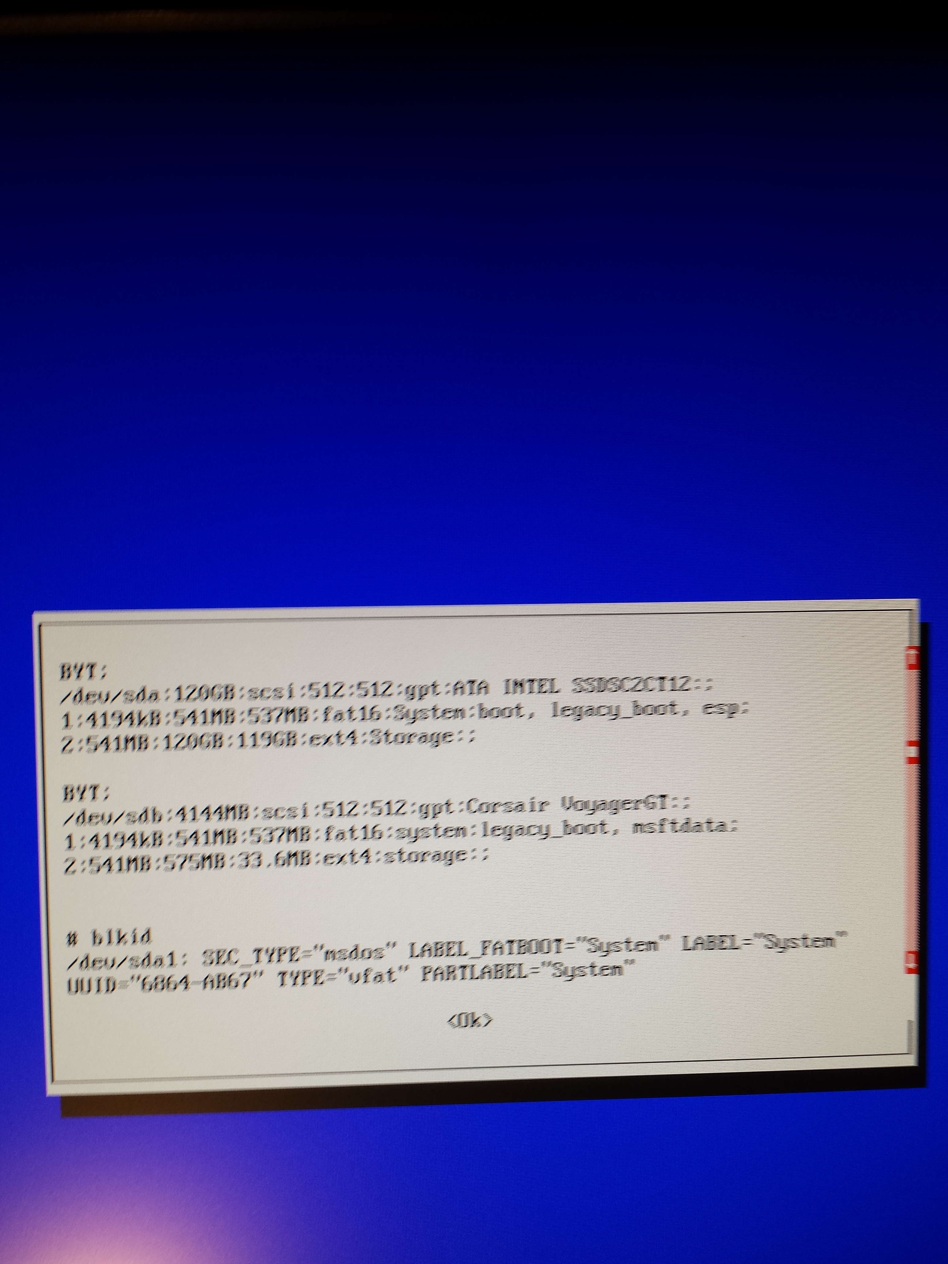

anyway, tried another stick (Corsair VoyagerGT on /dev/sdb with LE Release):
after the creator created the install stick:
cat SYSTEM.md5 => 52b0c54371949fe8785bd3d9eebf1b06 target/SYSTEM
md5sum SYSTEM => 52b0c54371949fe8785bd3d9eebf1b06 SYSTEM
and after the installer installed on the stick:
md5sum SYSTEM => f152a99128d2166c518680ed4738c235 SYSTEM
mismatch !

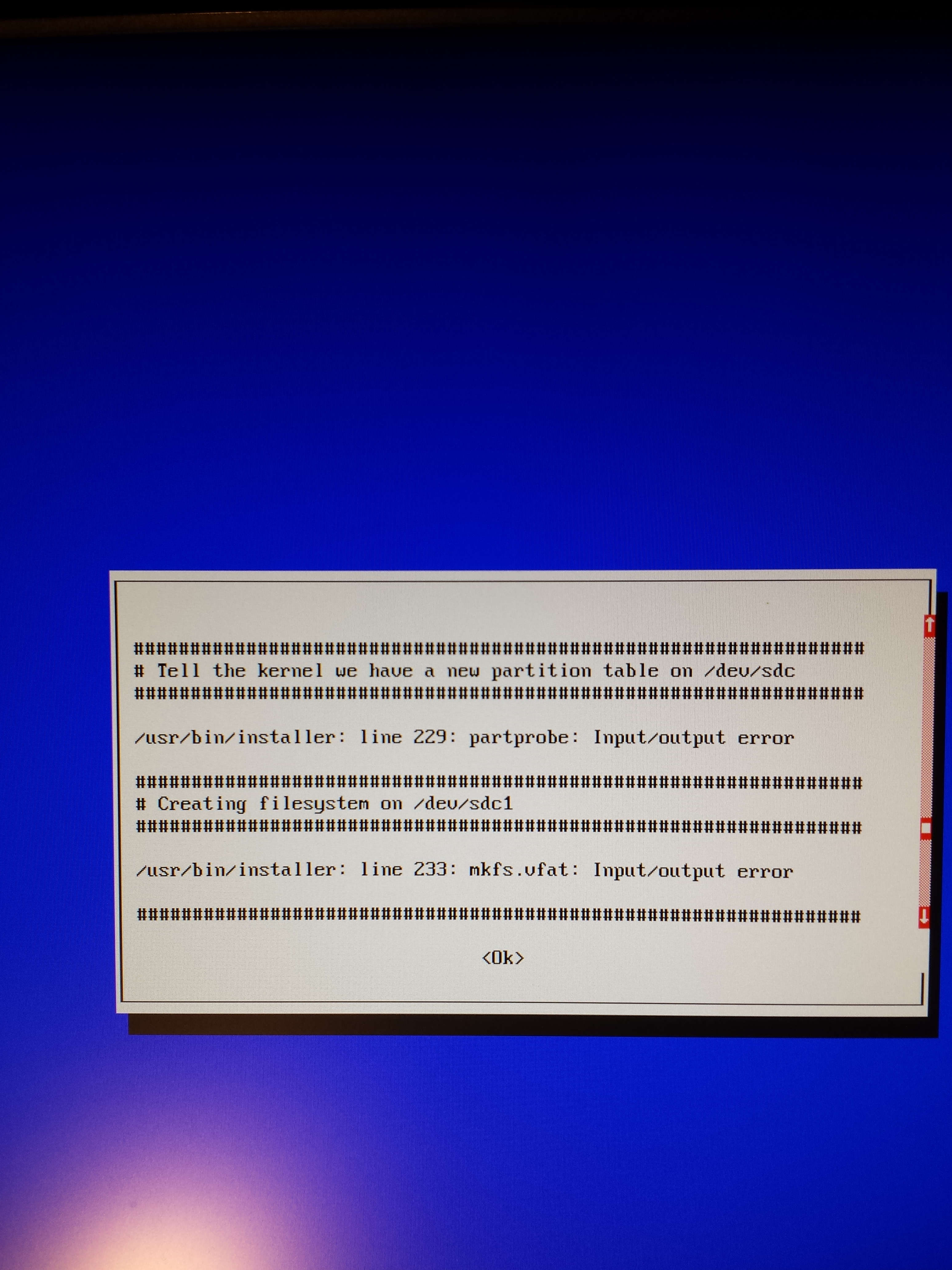

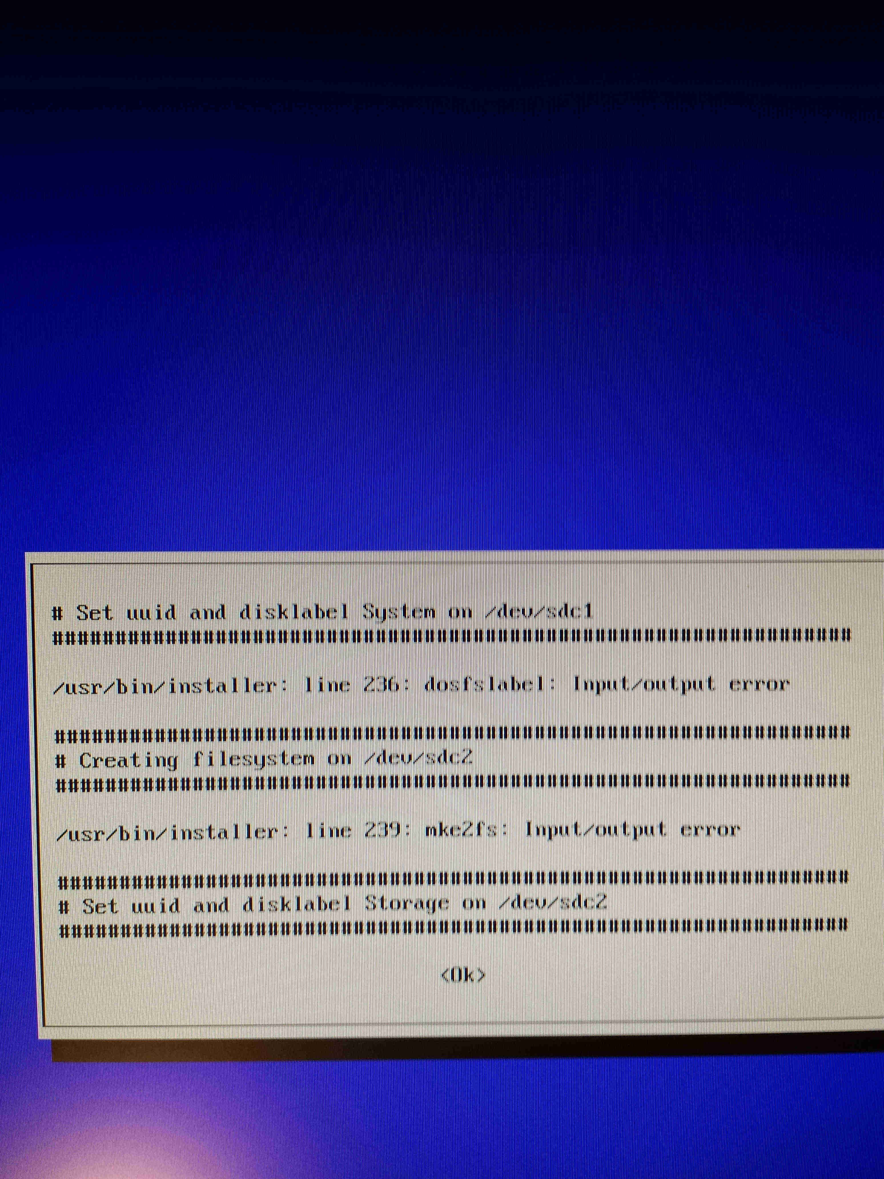

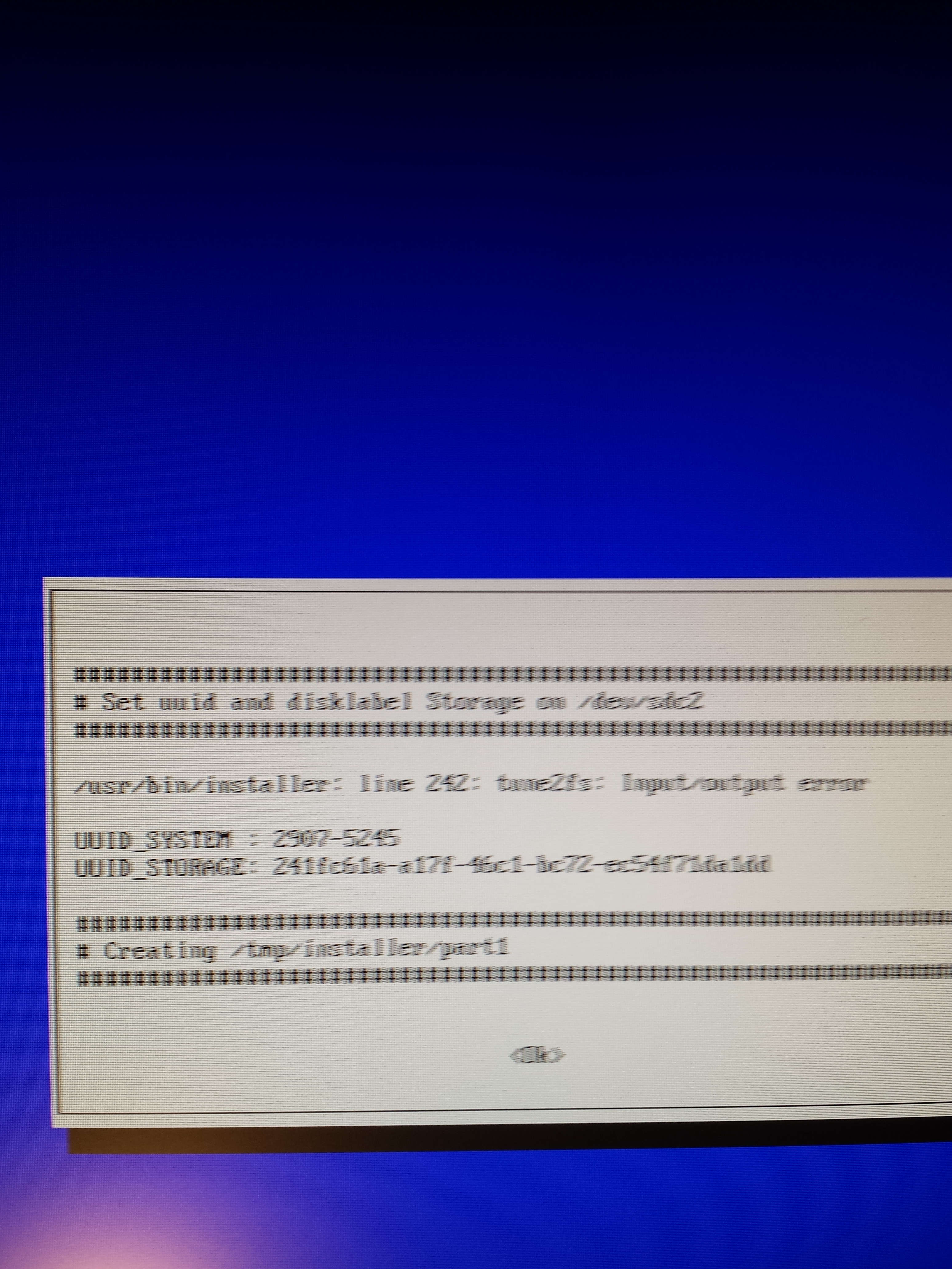

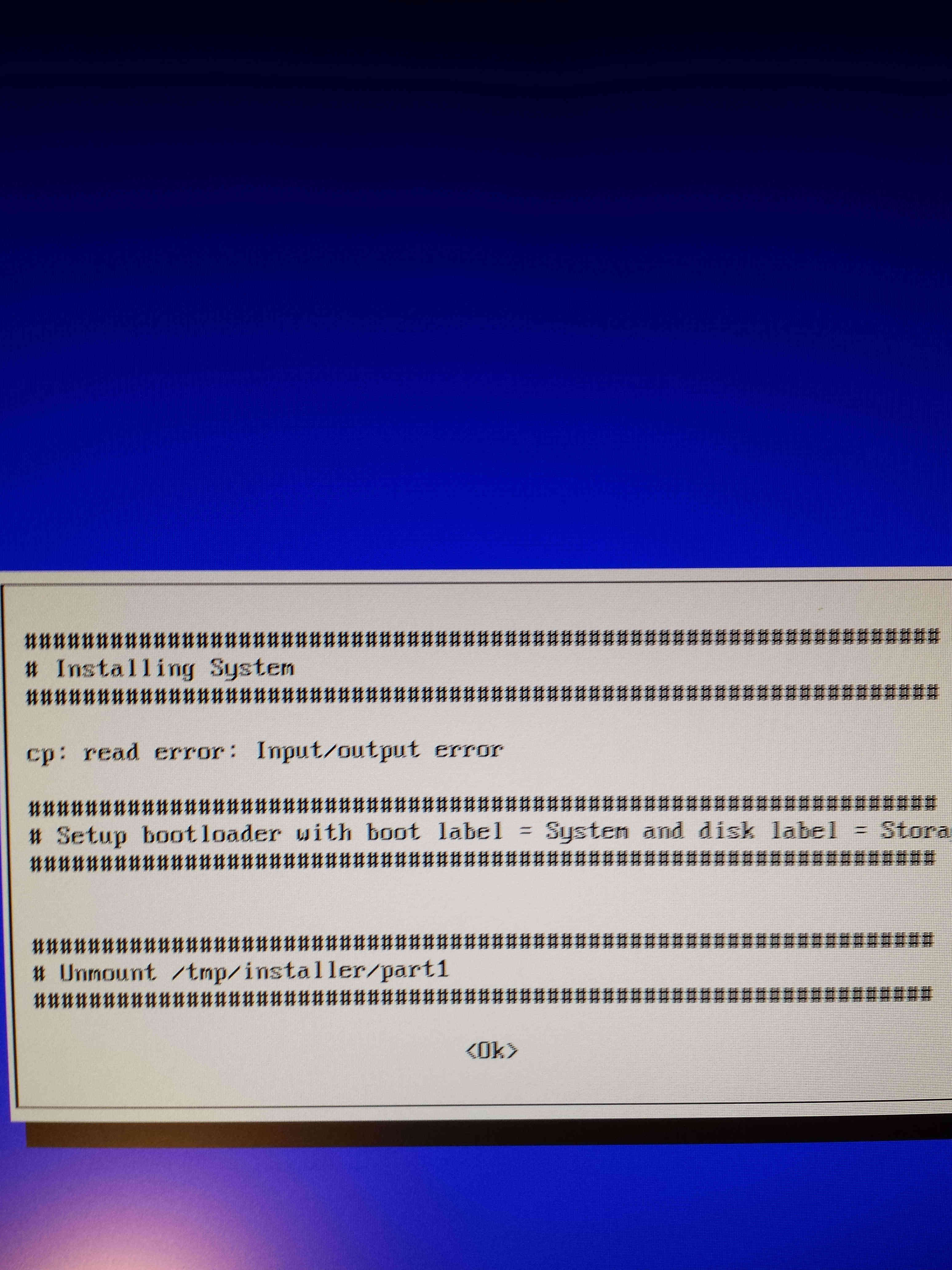

attached some photo's from the installer log file.
it seems the installer is running wild somehow and I guess the bug is here (esp. when installing on USB Sticks)

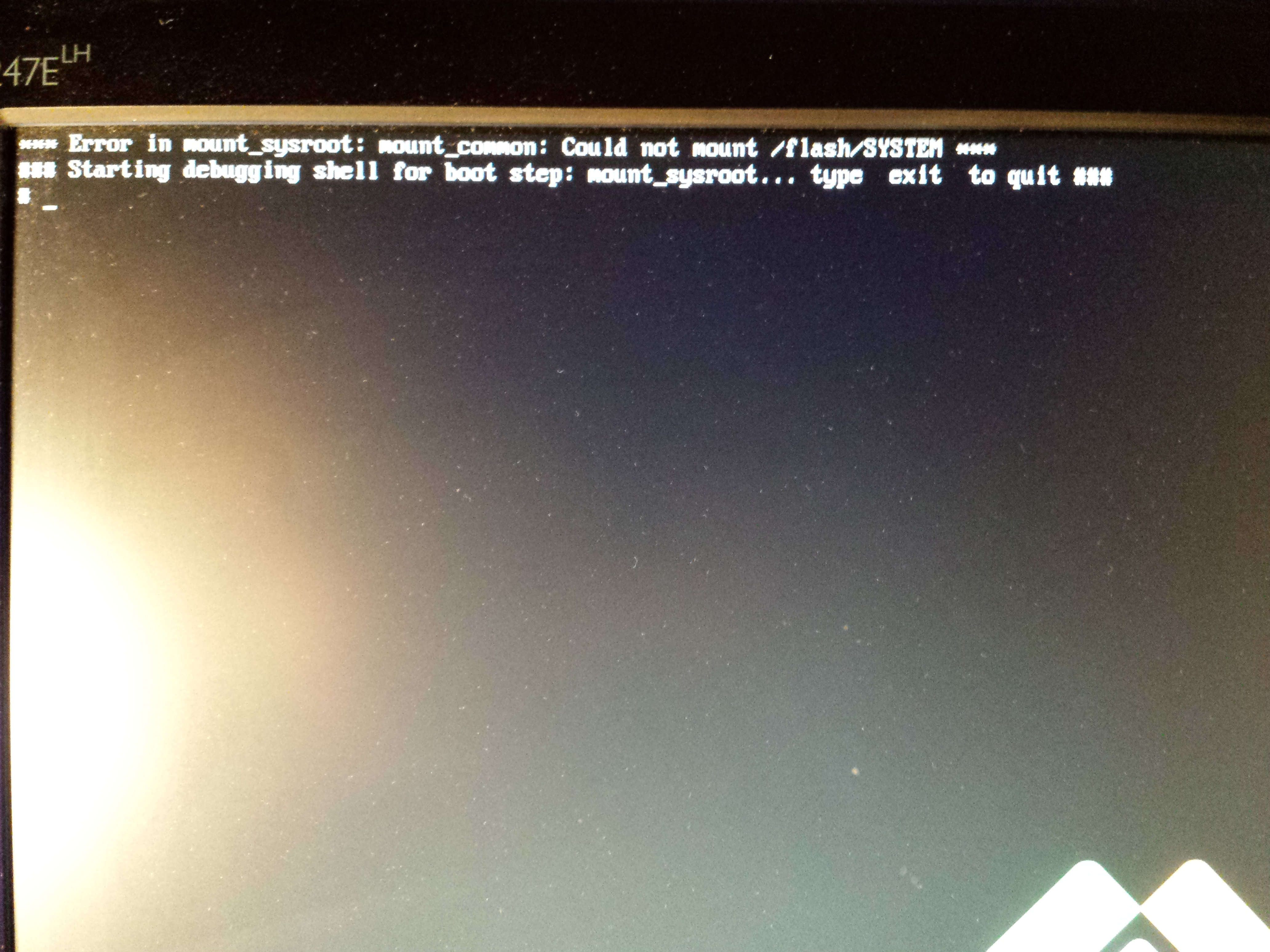

on an Sandisk: box boots into an debug shell.
on an corsair: box doesn't boot/see the stick (=> no boot flag set)
I wonder what the installer is doing with /dev/sdc
But I have to admit that I need to replug the stick that the installer gets aware of it.
the box is an NUC with only an Sata-SSD as /dev/sda
