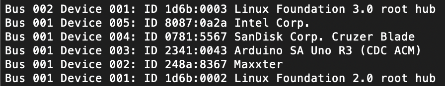

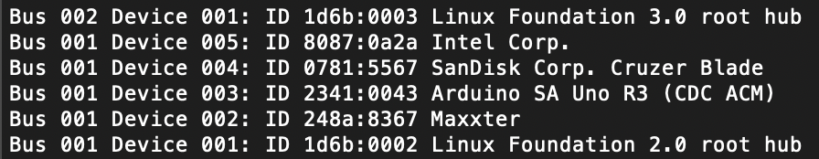

    I have another BT problem with my new board. Installed the intel M.2 Wireless AC 3165 Combo today but it detects no devices.
    The card is recognised by the system -> http://ix.io/2iXU

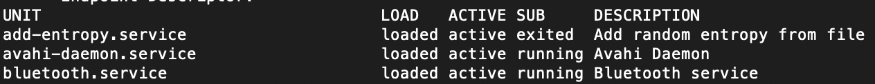

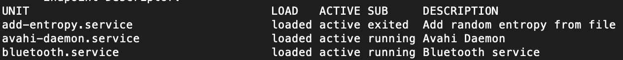

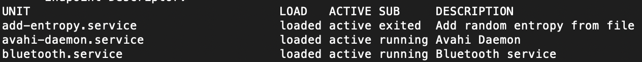

    Bluetooth is enabled in the settings and the service seems to run:
    Is there any other service I have to start in addition?

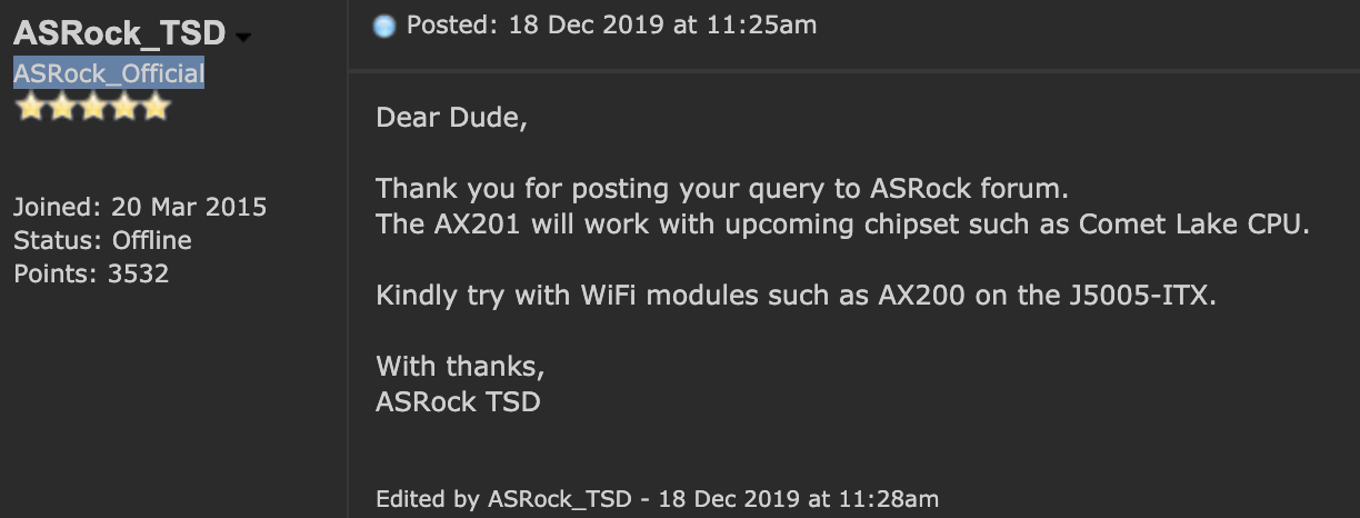

    It's also possible that Gemini Lake is a bit allergic to AX200/1 cards. The Asrock forum mentions some of them.

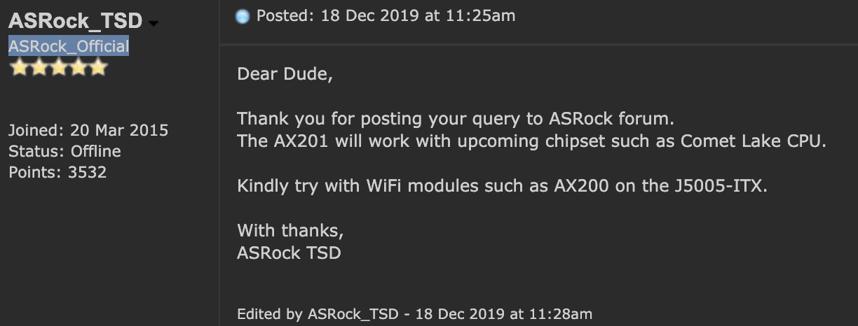

    I was looking into the forum as well and found an ASrock officials recommendation to AX200 for J5005. So I was quite sure it will work this time.

  • Looking at the logs, I can see that the AX200 looks ok. I’m using an AX201 on TGL, that needs the fw59 too. You are correct the AX200 is standalone, though the AX210 I purchased to test with does not work in my test systems. Locks them up. In my day job we have over 4000 AX200/AX201 windows devices that the 21.x driver is shocking and until 22.30/40 pretty poor. 22.20 was ok ish. I would like to see you running the LE10b2 code (kernel 5.10.30) which has had a number of little fixes both settings app / kernel ...
