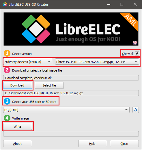

    1. If the toothpick method does not work, but you have UART access, first of all write the image suggested above to an SD card with this program.
      When finished, put the SD card into the box.
    2. Interrupt the startup process of uboot, then copy the contents of the aml_autoscript file line by line after the prompt:

    Thank you very much. It started on the first try.
    I leave the output of the session in case any data is useful.
    I confirm that it worked with the MXIII-1G image.

    Hi, I used the image Lakka-S8X2.MXIII-1G.arm-2.3.1.img.
    You can download from here. (It's an external link, take by your own risk).
    The only way I could get it to boot, is write the image to an SD card with this program. (thanks to dtech)
