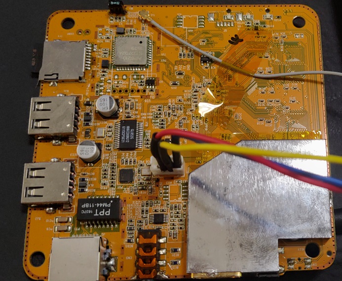

    Pressing the button on the board instead of pushing the toothpick through the audio port is the same thing. The SD card with the image that you want to boot should already be inserted in the slot, with the power cord disconnected, press and hold the button, plug the power in, the boot logo should flicker once and then you should immediately release the button and let the boot proceed. Holding it too long will force the Android recovery mode to come up instead of launching the image from the SD card. The u-boot date code is not antiquated to the point where image loads from the SD card are not available, as far as I am concerned.

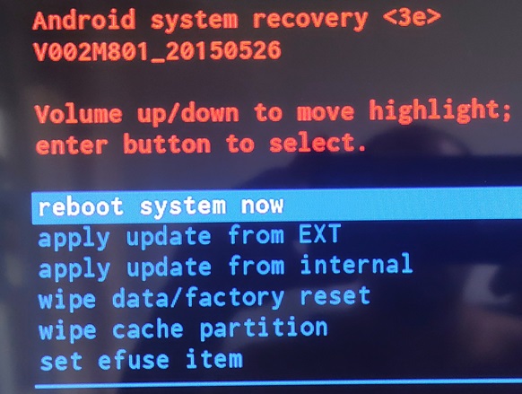

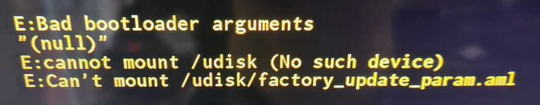

    I tried the 2 images and there is no way to get it to boot. I have no button behind the audio connector. I do have an update button under the board. When I press and hold it and connect the power cable it leaves me in Android Recovery, but it doesn't go beyond that. I think I have to change the boot.img to allow me to load any other image from the MicroSD.
    I don't know what I'm doing wrong.
    Since you do not overwrite the contents of the EMMC when booting from the SD card, you will not need to do a backup of the existing dated firmware, as illustrated in your log posting. To launch LibreELEC or Armbian from the SD card, you will need to follow the toothpick method discussed in these forums, once you have any image put on a SD card. You can obtain Christian Hewitt's LibreELEC images using his AMLMX builds, Gabor Dee's excellent legacy LibreELEC build, found in these forums, or grab SLAzurin's build of S8xx Armbian from GitHub, which also has a sample image for download that can be used. Once you have something coming up, I can go at length into getting things up to the latest 2024 releases.

    From what I understand, the toothpick method is to boot the TV BOX in "Android Recovery" mode, is that correct?
    I can do that, but I can't find a way to create a MICRO SD which will boot.

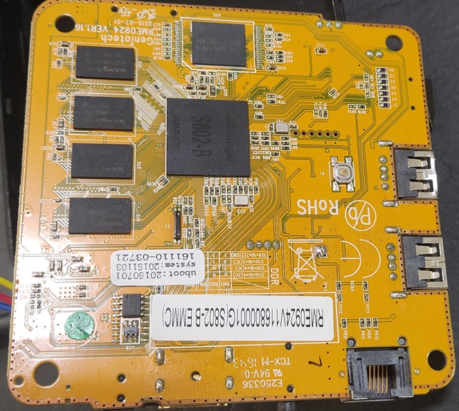

    Hi, I am trying to boot any ROM or linux image on this TV BOX. I can't get it to take the MicroSD. The CPU is an Amlogic S802-B.
    I understand it is 32bits.
    RME0924V116800001G(S802-B EMMC)
    GENIATECH RM0924 VER1.16
    2015-07-01
    UBUT: 20150701
    SYSTEM: 20151103
    161110-03721
    I have access to the UART and this is what I got from the output of the ttyUSB0.
    Any hints?
    How do I bakup this system?
