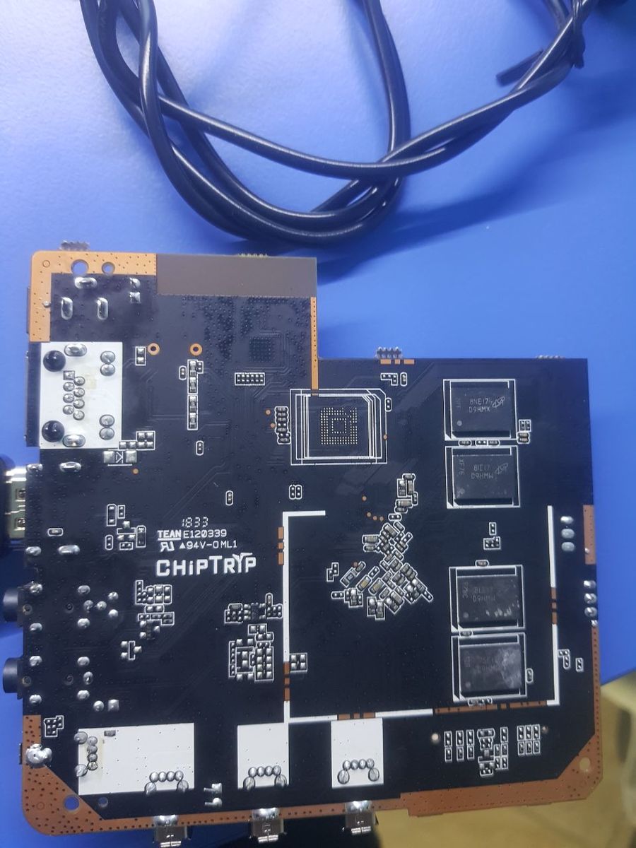

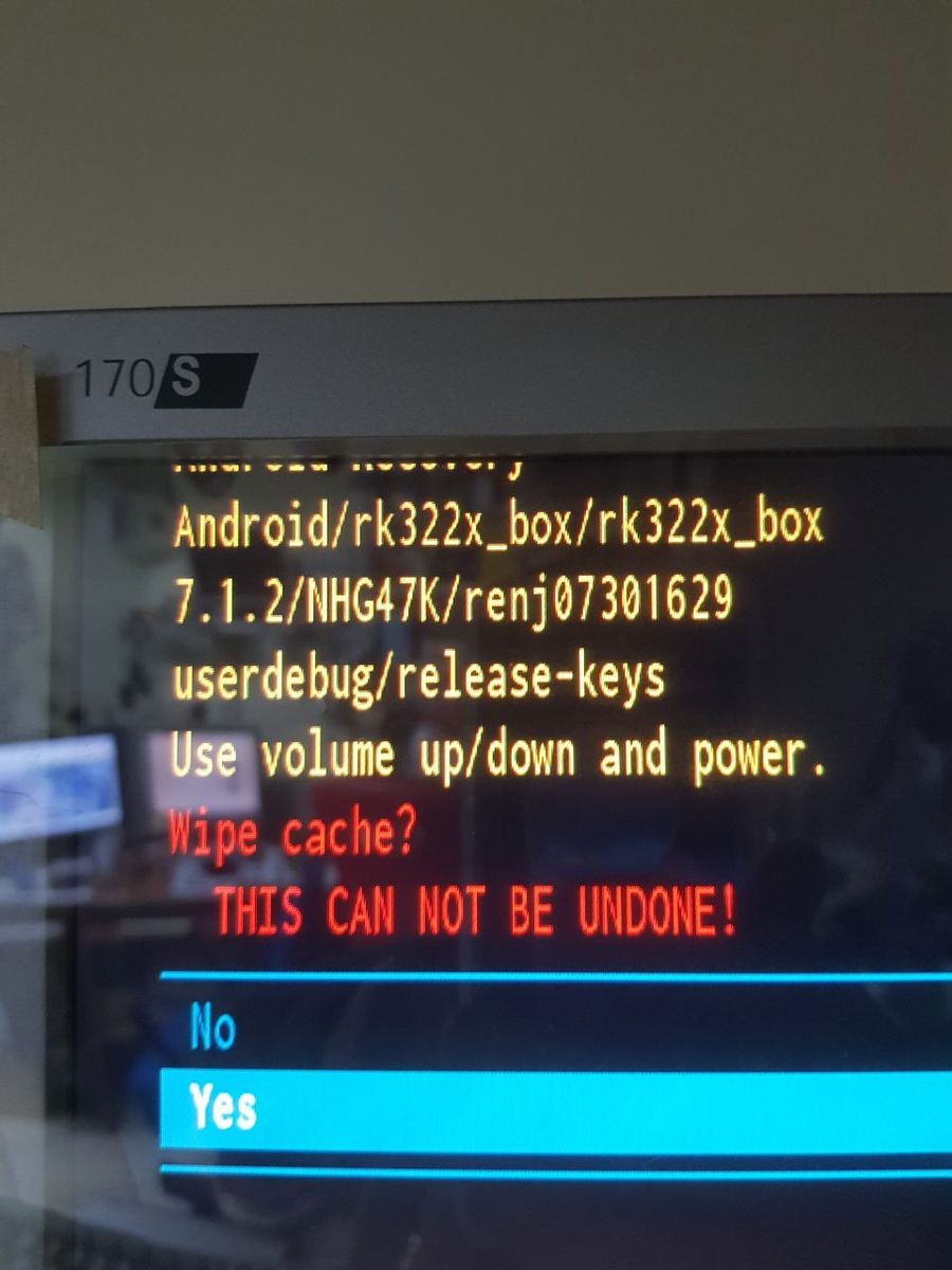

  • hello everyone... i have a problem with my box android...when go reboot. i want tried to update.... you can help me with instructions?
    i attach motherboard and version on my box....thanks advance and happy new year all you
  • giancai best to ask for help in a forum like freaktab that specialises in Android devices and ROMs .. we're not one.

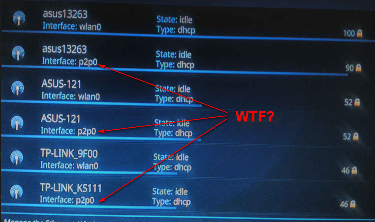

  • The libreelec is running smooth and the wifi connection can be established. But after rebooting the box, the wifi is not reconnecting again. It needs to be connected again + entering the wifi passwort again. Did you observe the same behavior?
    Have the same problem with my TX2: wlan password has dropped during every boot.
    Each access point is duplicated besides.

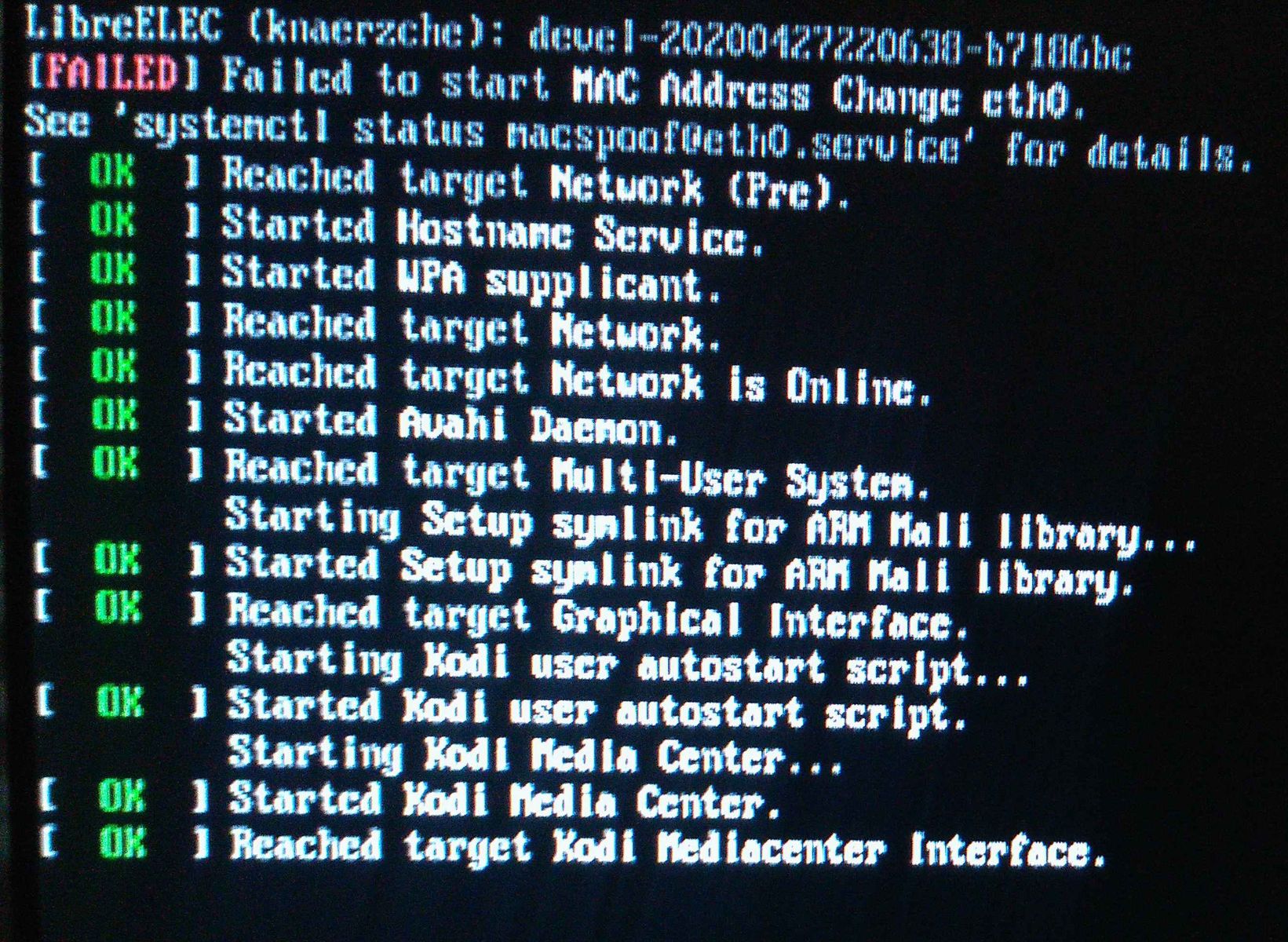

    Try do like there but can't find any folders: "udev.rules.d" and "configfiles".
    Previous methods ("autostart.sh" and "[email protected]") are not worked.
    I located this folder, make those file - no any results.

  • Now I have autostart.sh in 'storage/.config/'
    [email protected] in 'storage/.config/system.d/'
    and 99-mac-address.rules in ''storage/.config/udev.rules.d'
    with that msg:
    MAC adress still changing every time.
    Can I do like this:
    or something like this:
    and where it must be placed?
    Edited 4 times, last by UART: Edit ().
