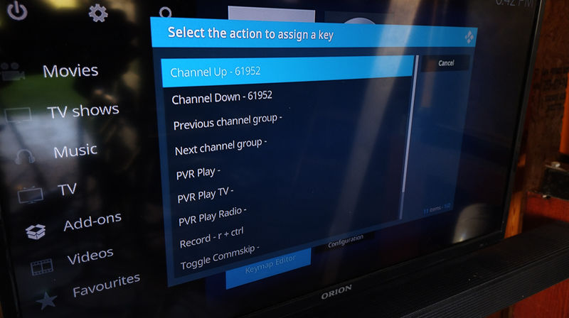

  • Maybe its allready solved, i know the post is nearly a year ago.
    But for those who still look for a solution:
    Open Libreelec in Settings, go to Bluetooth look for devices.
    Press and hold your Fire TV's home button until the LED flashes orange.
    You'll find a Bluetooth device called "AR" connect to it. Its your Amazon remote.
    Go to Game ad dons -> controller profile -> and install "TV remote"
    Restart Kodi!
    Now you Fire remote will work now. Except the context menu button ;(
