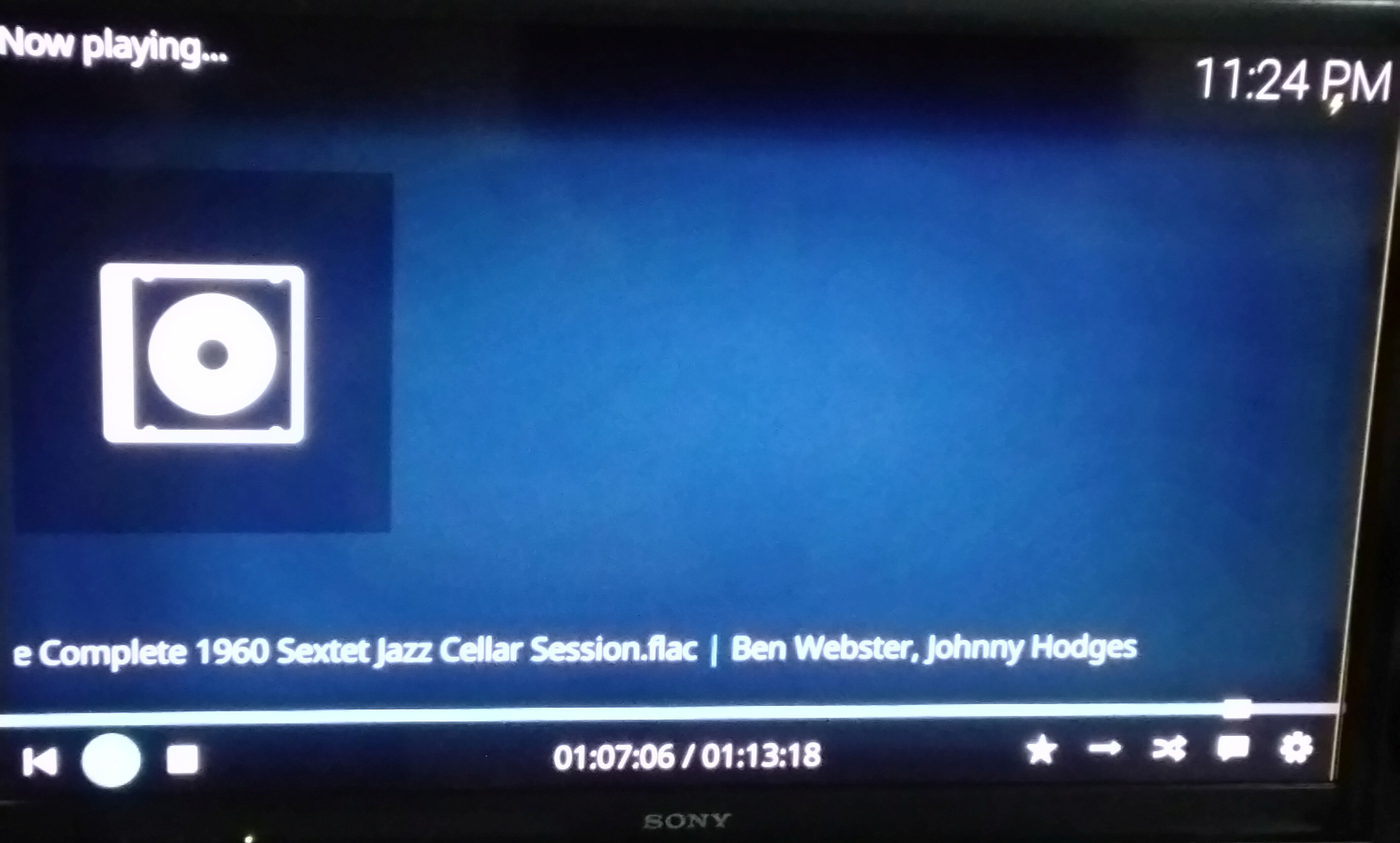

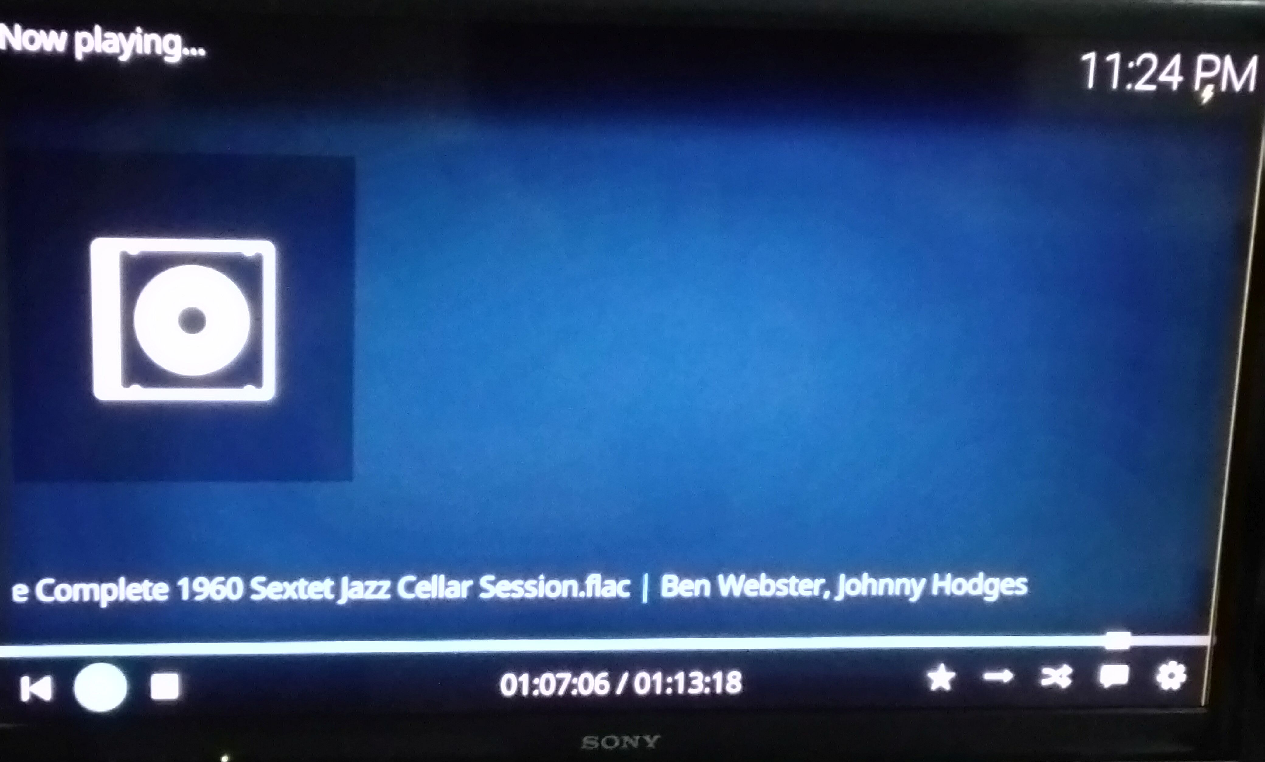

  • Hello all.
    This is my first post re my Pi3B+/LibreELEC/Kodi set up. I get a lightning symbol popping up top right corner on the screen for 3-4 seconds every 30 seconds or so There is also a thin yellow vertical line down the right side of the screen which stays on all the time. Are these cause for worry and, if so, what should be done about it? (Does not affect any of the functions though.)
